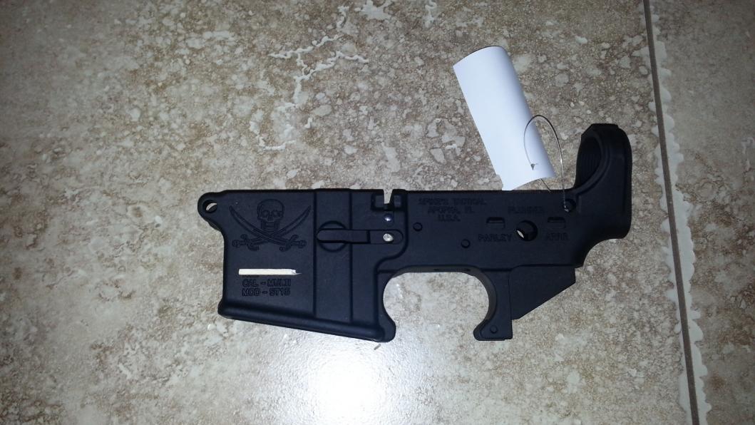

                      So I picked up the lower for my AR15 build. Here she is!
Name:	Lower - Spikes Tactical.jpg
                      • #26
                        Building them is a lot of fun! Too bad they build so quickly and easily... Would love to build one a week, if I could...

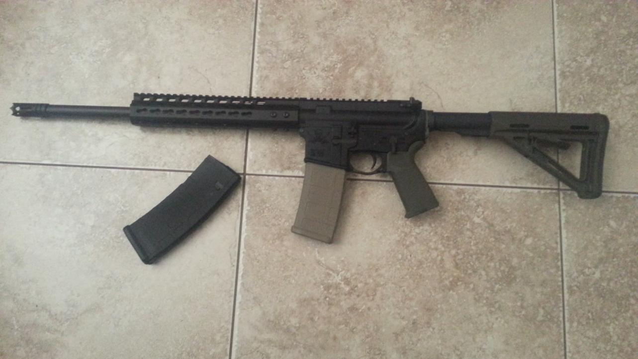

                          With the exception of the flip up MBUS sights, "Betty" is complete.
                          Here are her stats:
                          Upper: Spike's Tactical
                          Lower: Spike's Tactical
                          BCG: Spike's Tactical
                          Barrel: Black Hole Weaponry 16" with 1:8 twist and a standard profile
                          Gas Block: Syrac Adjustable
                          Rail: Guntec USA 10" Slim Profile Free Floating Keymod
                          LPK: DPMS (including trigger)
                          Stock: Magpul MOE
                          Pistol Grip: Magpul MOE
                          Weight (Unloaded): approx 5.5 lbs
                          I will pick up the sights this weekend but probably won't be able to shoot her until March 7th. I'll let you know how she does.
                          • #28
                            Nice and light... Simplicity... Let us know how it shoots and behaves...
