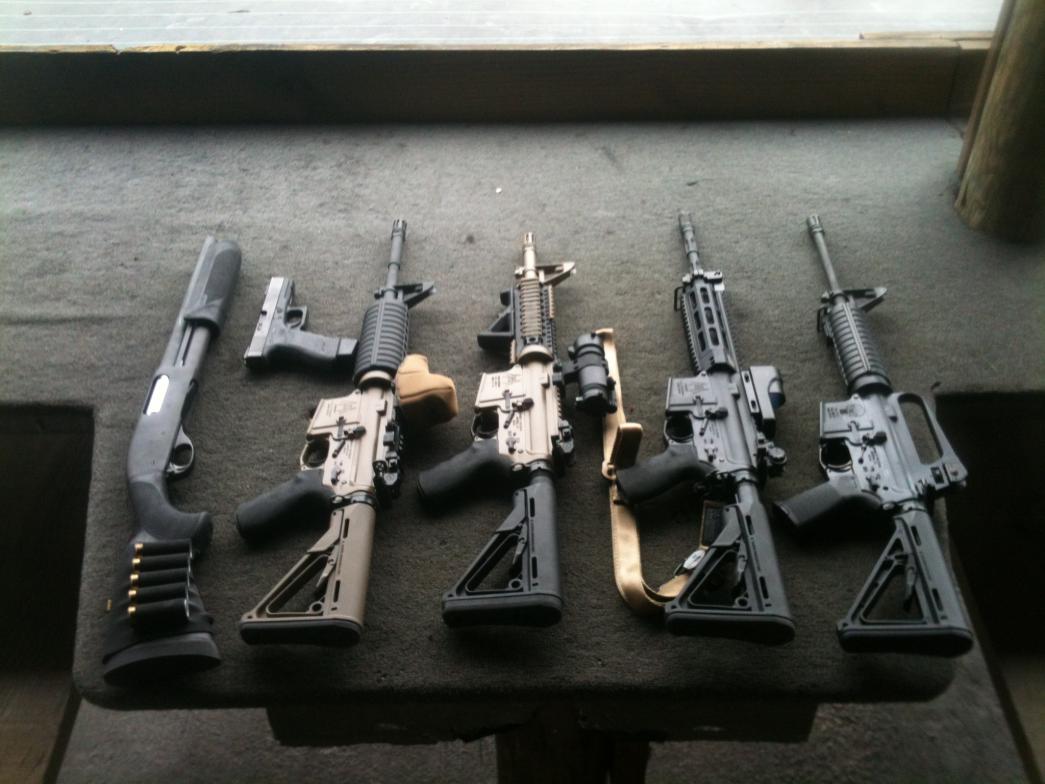

ID:	107969 My spikes collection a few years back.
                              [ATTACH=CONFIG]2480[/ATTACH] My spikes collection a few years back.
                              Very nice!
