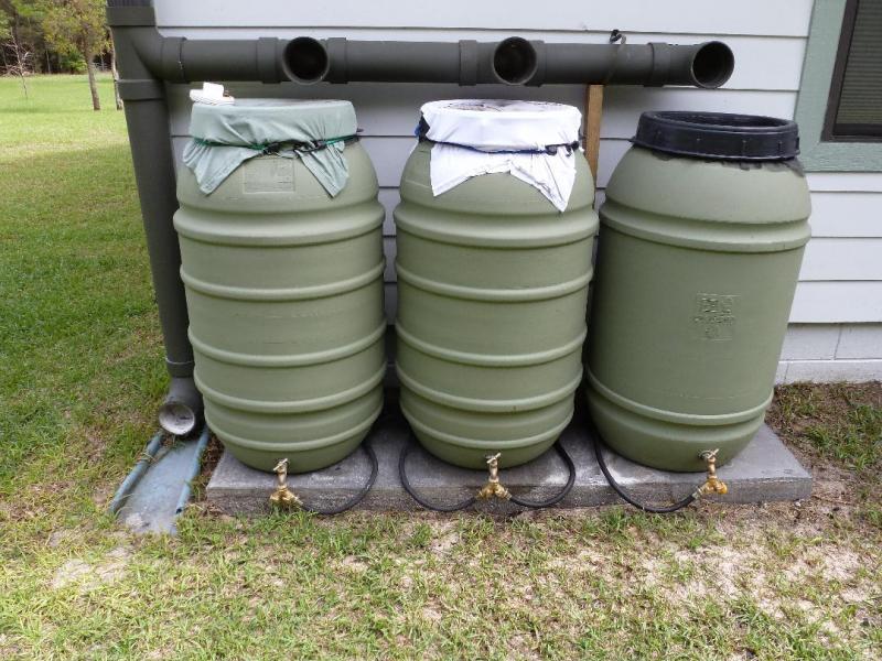

                      I used lowdowns water barrel idea, and expanded a little. These barrels use only 1/4 of the house roof area, and all three will fill up with about 1/4" of rain and they are all connected at the bottom. Click image for larger version

                        Nice setup...i need to find me some pickle barrels...wife wants to spend $ on one of them purdy ones...doh :)

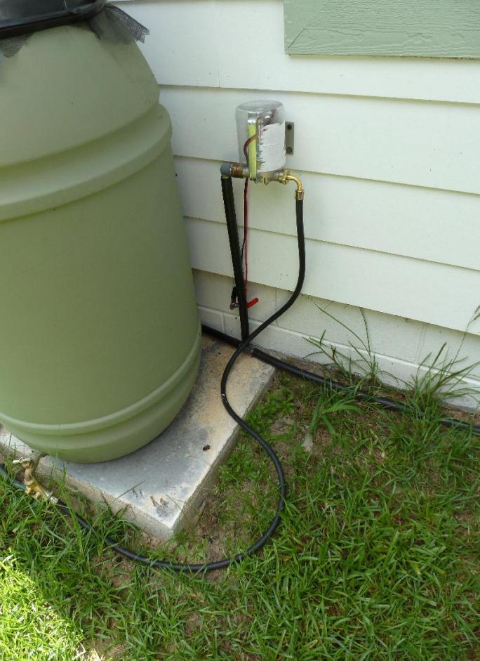

                          These barrels are nice, and I painted them the color of the house trim and they are on the back corner of the house. I have more barrels and pvc stuff to do another set in the front. I also put in some black rolled pipe run to my fruit trees, and a small dc pump to water the trees. Also the pump can be used to run the water into the house if needed.

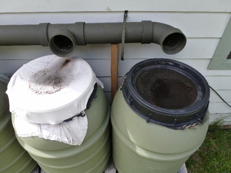

                              A little update. The barrels have screen under the screw down ring, but they still let in a lot of stuff. I bunge corded a t shirt to the top and you can see what it picks up.

                              I also added a small pump so that I can pump water from the barrel to my fruit trees. Also if needed I can hock up a hose from the pump to a faucet at the rear of the house, and use it for water in the house. This would not be used unless an extreme emergency, as it's not realy needed and would contaminate the house water system.

                                I often wondered if in the piping by putting in a layer of astroturf like in the bottom of a gold miners sluice box would catch debris before it reached the barrel
