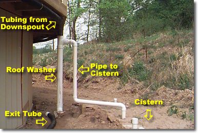

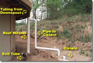

        It's called a roof washer and all you need is an appropriate length and diameter pipe calculated on the roof area you're collecting from. I don't know the formula off hand but I have it as well as several diagrams and resources at the office. The "washer pipe" is located directly below the downspout and a T and 90 are inserted at the location which achieves this volume below it and the collection pipe is attached to the 90 and leading toward the collection source. A small 1/4" hole is drilled at the bottom of the washer pipe which allows it to drain between rainfalls but is too small to have much effect on a good rain. Google roof washer and you'll be set.
          Great How To!!
          @Rmplstlskn - http://thenauhaus.com/blog/index.php...2/roof-washer/
          First flush diversion is a good idea to avoid capturing the first bit of a rain to wash the dust and dead squirrels off the roof. 10 gallons per 1000 square feet is a good rule of thumb. There are fancy gadgets for that, but a standpipe with a valve at the bottom seems to be the one that works. It ties into the gutter right before the downspout, so it has to fill before water can flow past it to the downspout.
          A 6″ pipe holds about 1 gallon per foot. An 8″ pipe holds about 2 gallons. How can we make it look good?
