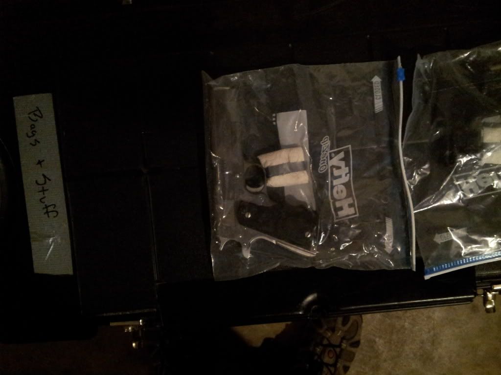

    And pistols were done somewhat the same way. However, running out of the small craft bags I was using for desiccant packs, I improvised even more and used a paper towel. Probably not the best of choices, but I’ll get to that.
    Here are a 1911 and a Tokarev in their bags:
    (Also, please don’t tell my mother I own a 1911, she still thinks I’m respectable and work in a cat house)
    And the Tok:

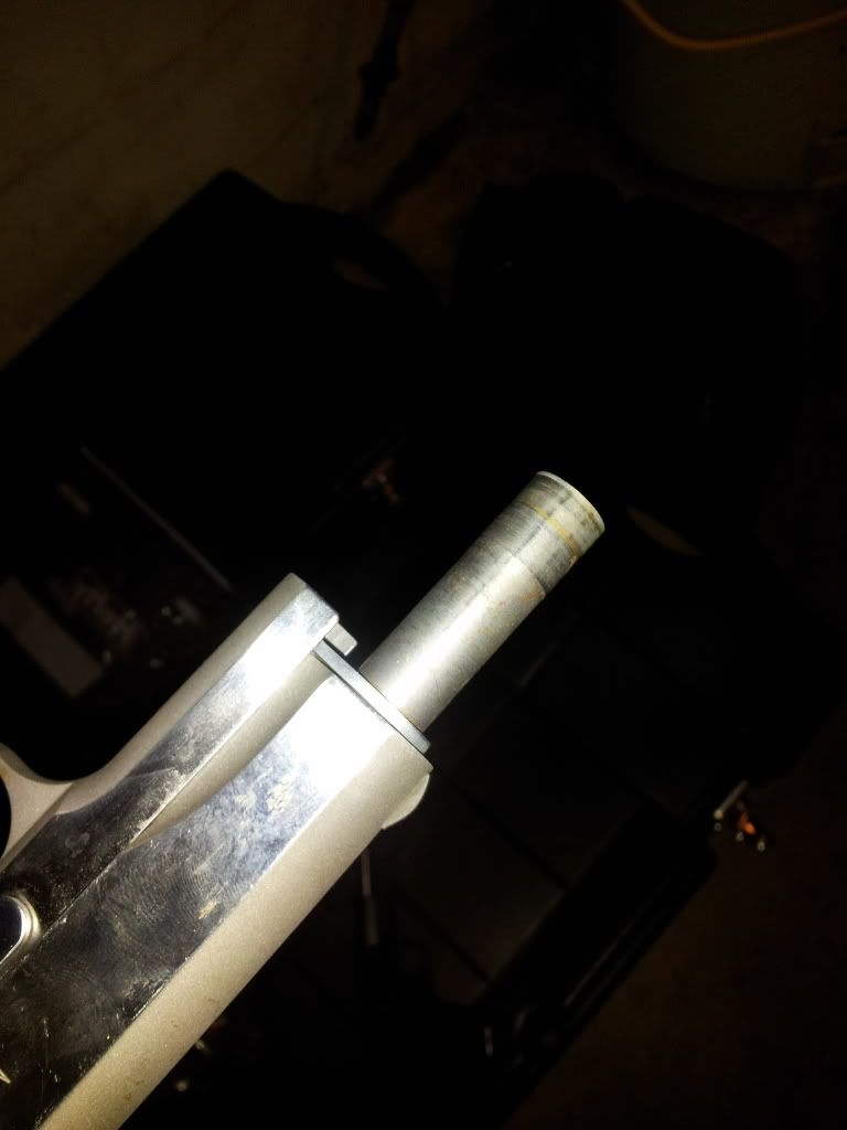

    Two things went wrong I believe. The Tok was placed into storage in 2006 and IIRC, the 1911 in 2007. However, my choice of a paper towel for a desiccant package might not have been the best idea. Both the 1911 and the Tokarev showed some corrosion. You can see the slight ring around the 1911 barrel and the interior of the Tok barrel was rusty.
    Tok
    So lessons learned: Use the same materials on both. I should have used the small craft bags for the desiccant packs, but ran out and improvised. Maybe not the best item. Also, when storing, a generous amount of oil to include the barrels should be applied. They will come clean I’m certain, and the function check went off without a hitch. Just a tad more oil probably would have helped out a lot more.

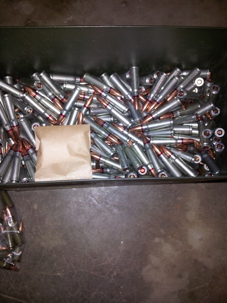

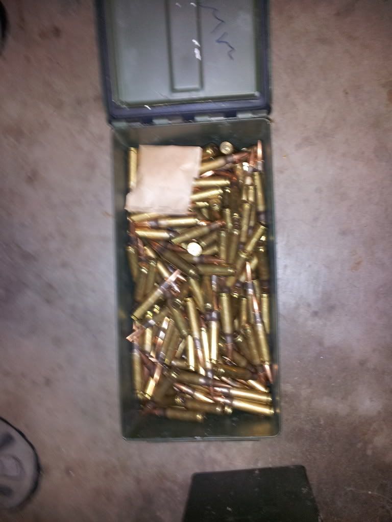

      And the ammo. I picked the 7.62x39 ammo since I knew for a fact it was packed away in 2006. And another random can was the 7.62x51. Random picks.
      The ammo was still airtight even five years later. I packed it up in Colorado and never opened it since then. It was hard to open and the pressure change of less oxygen at altitude in Colorado made opening them a little harder. But I got it open and looked just like it did the day I packed it away.
      And the 7.62x51 ammo was the same:
      No serious trouble with storing ammo for long term. I used the desiccant packs and they worked like a champ. Even the temperature changes over a five year timeframe didn

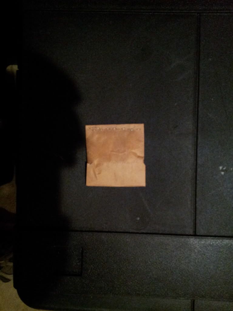

        And finally the desiccant packs. I picked up a pack of the small craft paper bags at Michaels. Filled them with standard flower drying silica gel and stapled or taped the ends up. Didn’t take much, maybe a spoonful or two per pack and the paper seemed to work just fine.
        However, I don’t think the paper towel worked very well at all. I might have gotten better results with standard newspaper or something like that.

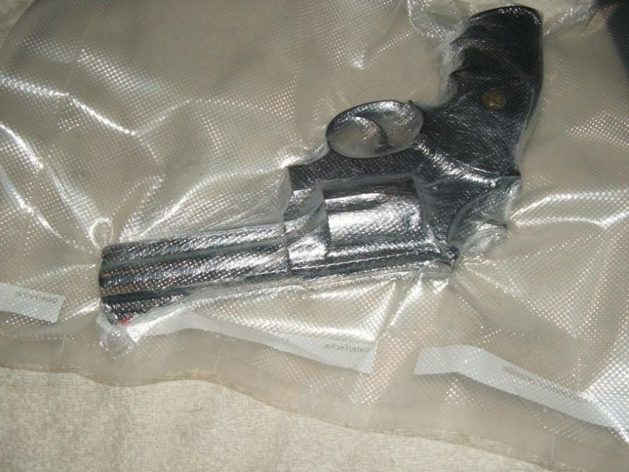

                            Okay, finally got time this morning to try it out.
                            First things-
                            I used two of my handguns- a Taurus PT145 compact 45 acp semi auto and a Smith and Wesson 686 Midnight Black .357 revolver to show the results on a fairly smooth gun with low sights and a larger gun with quite a few sharp edges
                            photo #1 is the vacuum sealer I used. It is a Foodsaver V3425.
                            photo #2 is the storage bags I used, Foodsaver brand bags.
                            photo #3 is the plastic wrap used.

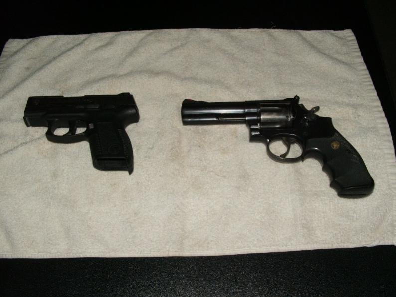

                            photo #4 are the test guns used.

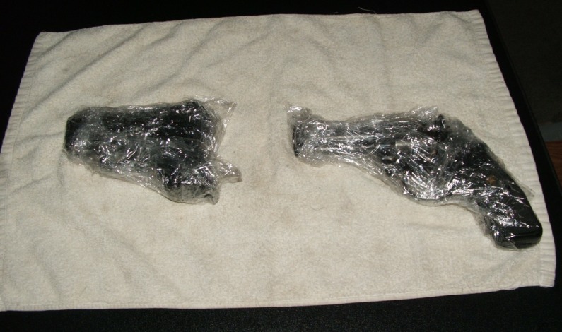

                            photo #5 shows the guns wrapped in 5 layers of plastic wrap prior to sealing, I did this to try and blunt some of the sharp points and edges (the S&W has a surprising number of sharp edges- sights and hammer are real problem areas).
                            Brokedownbiker
                            Sam Adams
                            John Adams
                              Now to the meat of the test-
                              I didn't oil the guns for this test as I didn't want to have to spend the time cleaning them off afterwards but if I were going to store them in a cache I would coat them lightly with the oil of your choice prior to wrapping them in the plastic wrap.

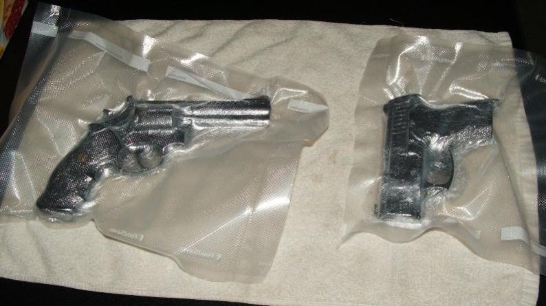

                              photo #6 shows the guns after sealing

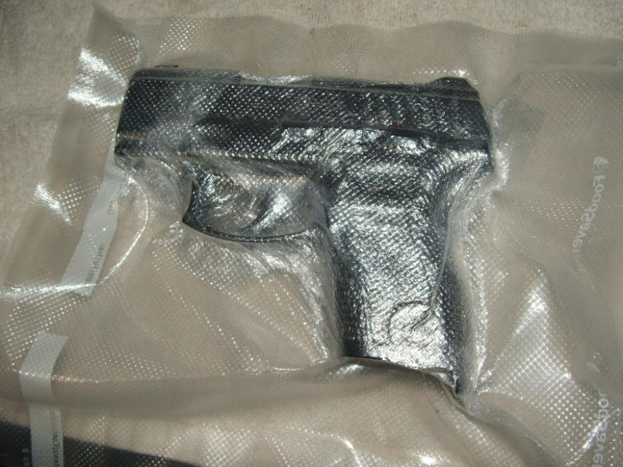

                              photo #7 is a close up of the Taurus
                              photo #8 is a close up of the Smith and Wesson
                              My impression is that this will be a great method for long term storage- with a few changes. Like I mentioned above, the oiling would be one, more layers of the plastic wrap with attention paid to the sharp areas and most importantly, I would add a dessicant pack to absorb any trapped moisture. I might try just a few grains of rice, it is known to be a natural absorber.
                              For a higher degree of protection, multiple layers of vacuum bags would give more depth to the protection.
                              All in all, I think this method will work for really long term storage with minimal risk of piercing or moisture intrusion for caching your "metal objects"
