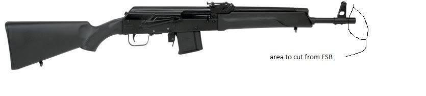

            if i had $800 to spend right now on my dream AK i'd buy an un converted Saiga 1st. then i would buy the UTG Saiga quad rail, tapco double hook trigger, a pistol grip and an AR15 type stock and get a bullet guide for the trunion and convert it over. the front sight base i'd press off cut press back on, and have a gunsmith thread the barrel for 14 LH threads AKM muzzle devices.
            what I'd end up with is an AK thats accurate, has more rail space and more handguard area than any other AK, that takes a myriad of muzzle devices and I'd only have about $600 into when it would be all said and done.
            as a matter of fact if funds permit this year I intend to do just that.

                  I understand most of what you said except for the front site base removal, what is cut?
                  I have seen places that offer barrel threading for the AK platform, is a stock AK not have a threaded barrel?

                      arsenal sells parts for the saiga/sgl series of rifles. the FCG is your standard single hook AK FCG. I've watched a video on youtube where a guy doing a siaga conversion replaced the gase tube with an East German AKM tube he had to do some fitting on the tube.
                      if you are looking for a 2 inch groups at 150 yards you can quit looking at the AK you just aren't gonna get it. the AK is a combat rifle not a precision varmit rifle. there is no free lunch in this world. to get that legendary mud slinging reliablity something has to go and thats precision accuracy. thats not to say you can't hit anything with it its just not going to double as a short range sniper rifle. 3-5 moa is pretty typical with russian ammo. fyi the accuracy acceptence standard for the garand was 4 moa. that 3-5 moa will get you on the bad guy at 300 yards and perhaps a bit more.
                      understand its not an AR-15. its not going to work the same as one and you really can't make it work the same as one. you have to understand that its diffrent. the trajecory is diffrent and you need to learn it. the sights are diffrent the safety is diffrent, and the recoil and recoil impulse are diffrent. you can't cram it into an ar-15 shaped hole.
