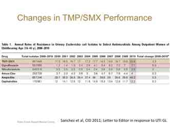

                  Look what's happening with Urinary E.coli.....
                    thumbnail is too small PSD even downloading and enlarging its unreadable.. We discussed previously about using a 2g Rocephin dose in either a single 2gram slam or two 1g doses followed by cipro course for 10-14 days.. In light of what this conference covered do you believe this is still a good course of action for serious life threatening events???
                      I guess you need to know what "bug" you're trying to cover. In 2000 Ciprofloxacin was showing a resistance rate of 1.2% for urinary E.coli. In 2010 it increased to 7.1% in over a half million isolates for urinary E.coli.
                      But, if you look at the H.flu isolates, fluoroquinolones seem to do well.
                      Bottom line, I store ciprofloxacin and will continues to stock it. But it won't be my first choice for a recurrent UTI. In a SHTF situation I would use it first line as it still works 93% of the time. If the patient wasn't improving within about three days, I would add an additional drug.
