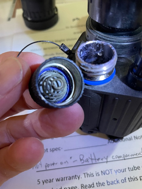

We see a handful of these every year. Someone who totally ignores the multiple warnings we give regarding not leaving batteries in their Night vision device.
Customer said this unit just "stopped working." When this arrived back here from the customer we were barely able to even get the battery cap off. What your seeing is corrosion from someone leaving a battery in there obviously a really long time... You know why it "stopped working?"

And you have more motivation than just your Dad being pissed at you- the replacement of the PVS14 housing is $600-700. for the housing currently. If you trash your housing because you didn't pay attention and left a battery in till it corroded the battery compartment, it could cost you this much.
In the above example- the customer of course didn't mention any of this on the phone yet when we received the unit here Helen Keller could have seen what happened with his negligence. We spent almost 2 hours cleaning the compartment trying to help the customer avoid upwards of a $600. replacement. We were able to get it cleaned enough for the unit to function again, but THAT'S NOT ALWAYS THE CASE!.
