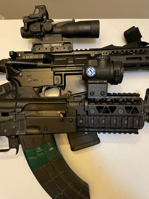

    Here is a couple examples of rifles that are set up to shoot "passive"-
    The top is a BCM AR with a 3X30 ACOG mounted on a Unity tactical mount. I've been very pleased with that Unity mount and will at some point in the future replace all my ACOG mounts with those. On top of the ACOG is a dual illuminated (not LED) RMR dot sight also made by Trijicon. Between the slight height rise with the Unity mount and the fact that the RMR is above the ACOG, this ends up being the perfect height *for me* for this use.
    Below is an Arsenal AK SBR with a Trijicon MRO dot sight on a "full witness" mount. I can see the iron sights through the base of this one ("full witness").
    A customer new to NV recently called and asked could he use his iron sights and go passive. That's not really going to work for most people, Really you need some sort of illuminated dot or reticle to work passively well. Although to be truthful I've had a student in class that was shooting a Beretta pistol during part of the pistol instruction that had partial tritium sights and he was shooting passive NV with it and making decent hits.
    That being said, for a rifle, even a cheapie $100. dot sight possibly on a riser, is going to make your life a helluva lot easier than iron sights when trying to shoot passive.
