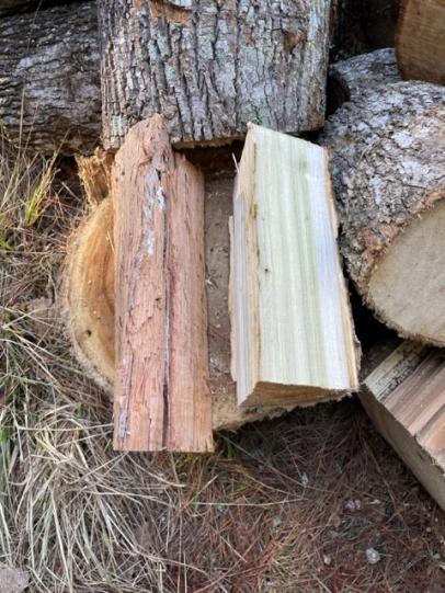

    The piece of wood on the left has been seasoned for at least 3 years, possibly slightly more. The piece on the right is fresh. They are roughly the same size.
    Looking at the above two pieces, it's easy to tell which is fresh. Sometimes it's not as easy. Then you want to compare the size of the piece of wood to it's weight. In the two above, there is a lot of difference in weight with the green wood being much heavier.
    You can also knock two pieces of wood together and listen for the sound. It will sound more "dull" if the wood is fresh compared to a sharper sound if it's seasoned well.
    Finally, you can get a moisture meter, but I honestly don't know anyone who does this. Usually if you are using wood regularly you get a feel for it and don't need this. However if you were new and buying some firewood, it might be worth it to test it with the above as well as possibly a meter.

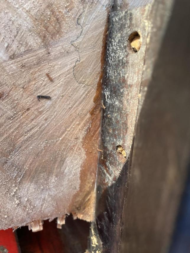

          The other day my son was cutting with one of them while I was balancing a log on the bucket. It's easier if you have one person cutting and one in the excavator, saves all the up and down getting in it. He uses the brake a lot when he doesn't need to. I don't know if it was that or what but the brake was off and he was cutting but I could see more smoke than normal. I called for him to shut it off.
          Had him take the bar and chain off, check the oil , etc. Found some light burn marks on the sprocket and a spot on the bar looked burned and a little deformed.
          We have most of those spare parts, but since I wasn't sure what caused it, I figured it would be good to bring in to the shop.
          Then I also ordered more spares :)

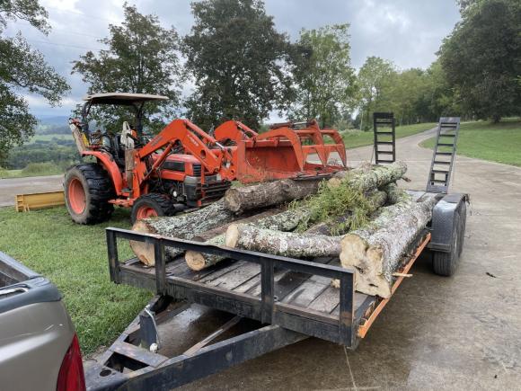

                    Using the tractor/grapple to load some logs onto my trailer. This Hackberry and Black Walnut went to a friend that was just starting in the wood burning lifestyle and needed some wood. I had an excess, so he got it.
                    Click image for larger version  Name:	ao22gcY.jpg Views:	0 Size:	61.4 KB ID:	114510

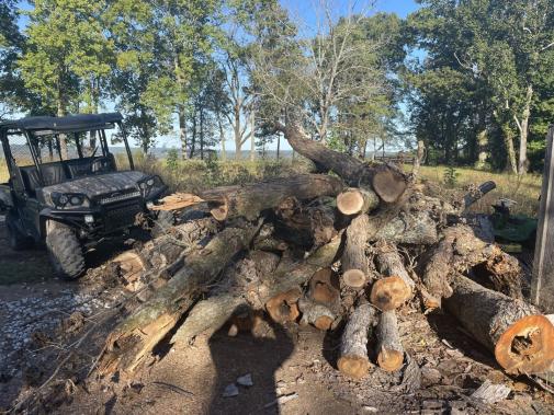

                    This was 2021 load of logs to be processed. Most of it was the remains of the former - by far - largest tree on my property, which came down during a wind storm. :( Most of this is White Oak; this will burn so well several years from now it won't even be funny!
                    Click image for larger version  Name:	zbNlH9V.jpg Views:	0 Size:	61.0 KB ID:	114511
                    The remains of the White Oak. :(
                    Click image for larger version  Name:	0UNuxGs.jpg Views:	0 Size:	63.0 KB ID:	114512

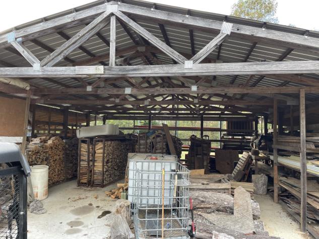

                    Pole barn. Left front and center: All Shagbark Hickory. Left rear is mostly Silver Maple with some Hackberry and a bit of Pine center rear.
                    Click image for larger version  Name:	IPa6FLm.jpg Views:	0 Size:	68.0 KB ID:	114513

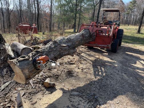

                    Bucking example. That's a Stihl MS-362CM with a 24" bar on it buried in a piece of Silver Maple.
                    Click image for larger version  Name:	6AKsSej.jpg Views:	0 Size:	59.9 KB ID:	114514

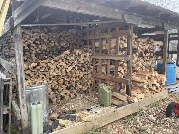

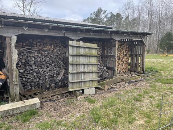

                      Woodshed #1; 3 bays ~3 cords each. First bay left is about half full of Sweet or Black Gum. 2nd bay is all Maple. 3rd bay is about 2/3 full and is used for Recreational Fires only. Note the trash cans/barrels. I fill those with splitting slash; they make excellent fire starters. Note NATO gas cans for the splitter. For this year, I'm filling the rest of Bay Home with a mixture of Hackberry (storm downed) and Black Walnut (power company cut down for line clearance). To only process 1-2 cords during firewood processing season is unheard of since I moved here 10 years ago.
                      Click image for larger version  Name:	aQoQX6P.jpg Views:	0 Size:	67.6 KB ID:	114516
                      Woodshed Forum I built thisSept.-Oct 2016. So it was filled no later than March 2017. I just started using some it this year. Bay #1, closest to the left, is full of Red Oak. Bay #2, middle, is filled with various hardwoods like Hackberry, Ash, Black Walnut and some Poplar. Bay #3, furthest right, is full of Poplar, hence the reason I started using it this year.
                      Click image for larger version  Name:	JcLfdR4.jpg Views:	0 Size:	62.3 KB ID:	114517

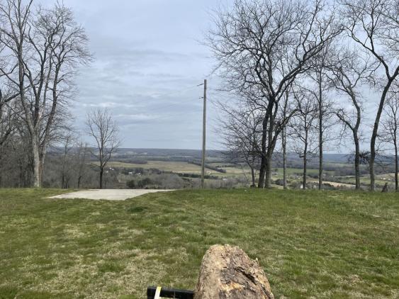

                      Scenic shot just for bragging rights!

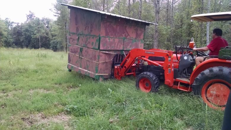

                              From top to bottom:
                              - Grapple stays on for when I need to manipulate something like logs or brush (most logs). It's my Home firewood processing tool.
                              - Grapple is also hydraulic; and also used to be a MASSIVE PITA to install due to limited hand strength and hand clearances. Fixed it with this tool as recommended by YTer Andrew Camarata: QC-Mate by XBoom Coupler (1/2" & 3/4" Duo-Jaw Set, 12” QC-Mate Clamp) - - Amazon.com​

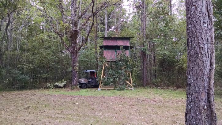

                              - 5x5' deer shooting house - my first one. Built it in my shop, transported, lifted it and then installed in place using my tractor and forks. Here's an example of moving my Pole Barn Field Shooting House:
                              Click image for larger version  Name:	vzRWhpp.jpg Views:	6 Size:	75.9 KB ID:	114528
                              As it sits today:
                              Click image for larger version  Name:	EpthIx0.jpg Views:	6 Size:	86.8 KB ID:	114529
