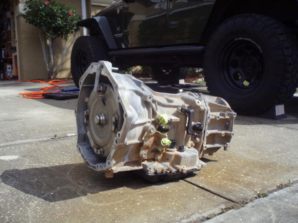

              Same here, I have always been a do it yourselfer. There is nothing like the right tool for the job. I have a collection of tools that continues to grow. Thank the lord that shops now rent the SST's out. saves me on buying one time use tools. Though harbor freight sometimes come in handy for that. Though I find myself going there less and less. Found a low milage tranny for $450.00. Putting it in tomorrow in my driveway. So wish I had a shop again.

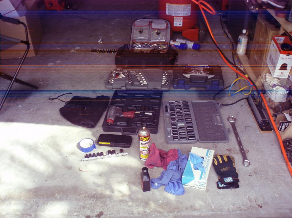

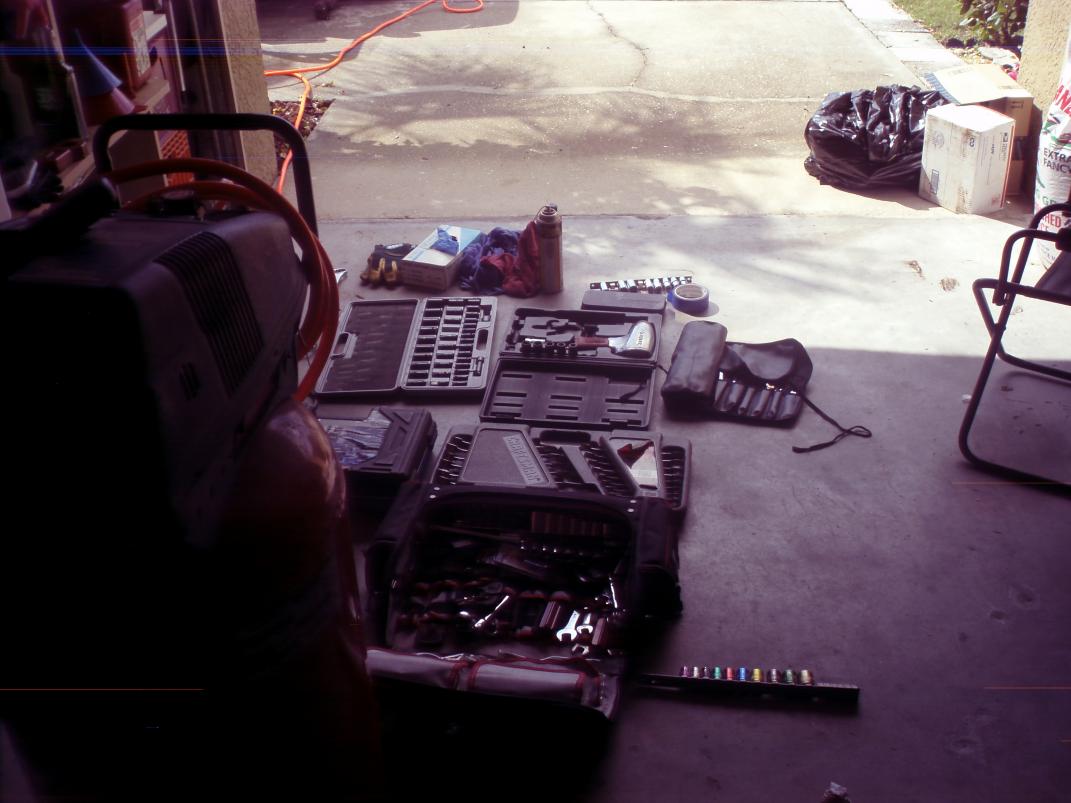

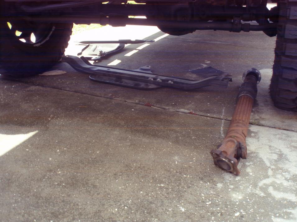

                      Just Buttoned her up, test drive complete, shes good to go. Didn't take many pictures.Click image for larger version
ID:	107990Click image for larger version
ID:	107991Click image for larger version
ID:	107992Click image for larger version
