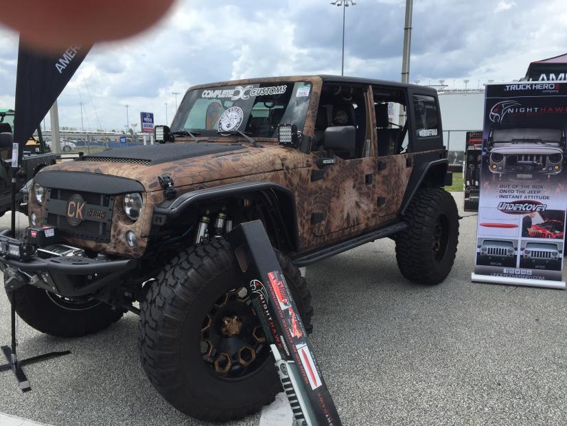

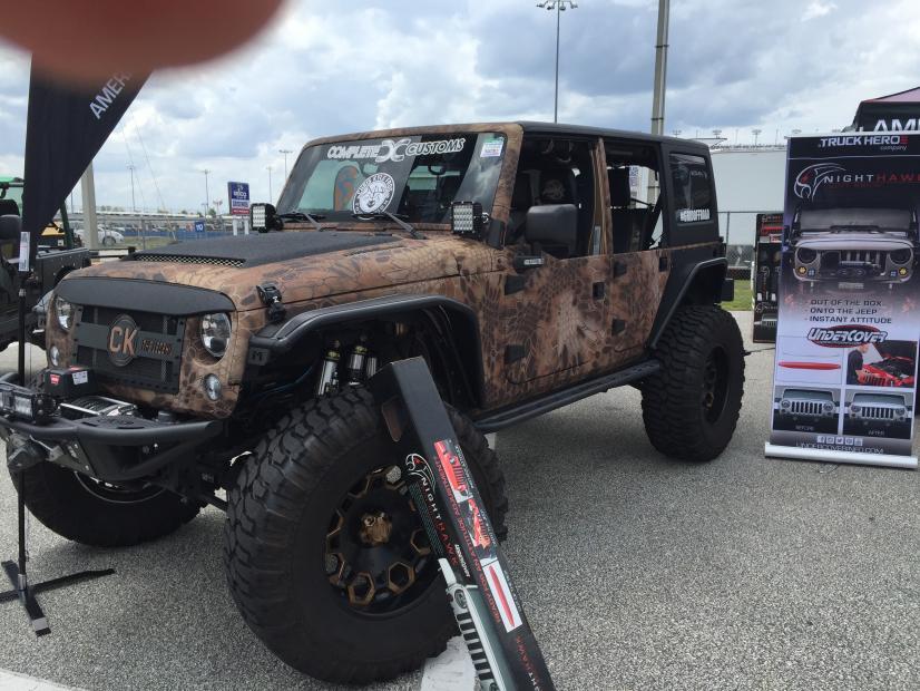

      Several of the SEMA/Show jeeps and Manufacturers (think Day star,Rancho, Warn, etc do this to their vehicles. Jeep Beach 2016 Bruiser Conversions had one of their "Pick up" JK wrangler conversions there. It was totally bedlined in OD green. I asked the rep there how it holds up etc. Said great for trails etc. you dont get scratch marks from the branches n scrub like paint (called pinstriping in the jeep community) but said they clear coated over this one to keep fading down. learned his lesson the expensive way on that one and was not sure if it was due to improper prep work or due to bedliner being pourus there was major rusting under that vehicles bed lining. they did use a flat clear coat on the 2016 vehicle. Just some cautions for you.
      This isnt the bruiser one but a wrap with a clear coat bedliner over the wrap for another option.

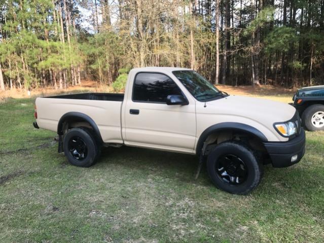

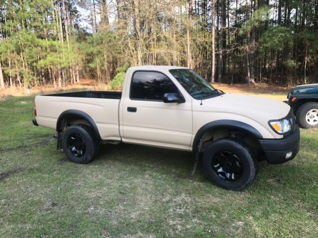

                Since the vehicle rarely ever leaves the property on our little corner of Southern Idaho here, I figured a pic wouldn't hurt.
                Came out good, had to drive about an hour to find a place that did that, no one around here seemed to know what I was talking about when I described the stuff.
                  Looks good. Lot of trucks set up like that down here. Grey for sure..
