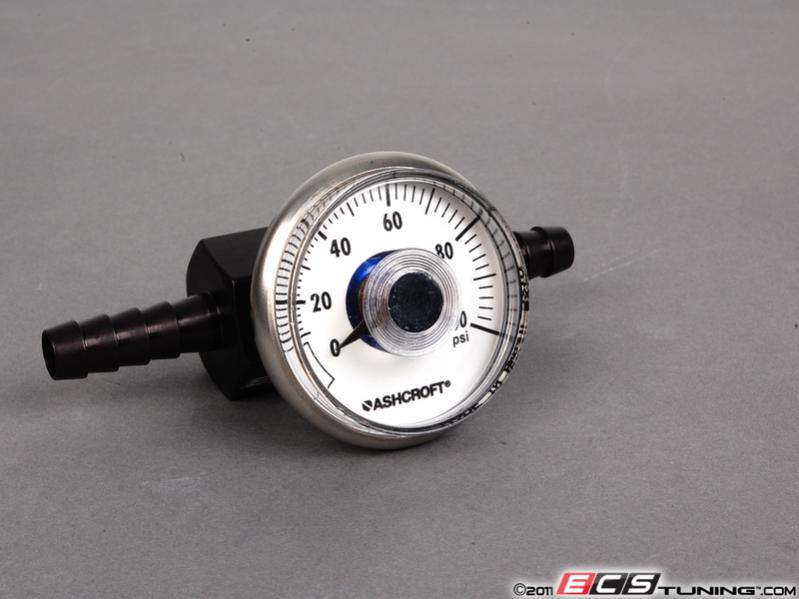

                1) Oil pressure. On most engines, there is an oil pressure sensor screwed into the block with two wires attached to it. To replace it with a guage, unscrew the sensor and screw in the sending unit for the guage. It has a pipe (either copper or plastic) that runs to the guage (mechanical setup).
                2) Fuel pressure. That goes inline after the low-pressure fuel pump in in the fuel line.
                Fuel Pressure Guage...inline with fuel line.

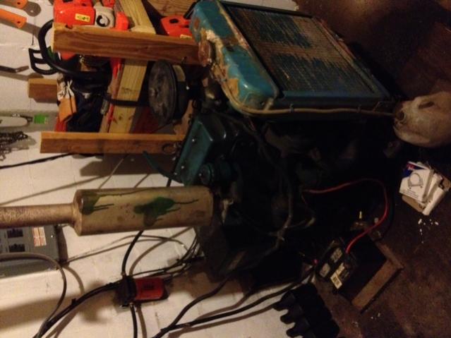

                  Just went through that building re-organizing things and putting wires that were run helter skelter over the years into flexible conduit. So I'm guessing that possibly this is the problem that caused the next problem-
                  Meters on inverter showed the hertz correct from the generator, once they synched the AC1 in showed 115 from the generator, yet no power seemed to go in to the battery bank. Voltage on bank showed 24.5 the whole time. Usually it starts immediately shooting up and puts a float charge in the bank in no time (Genset is 12KW).
                  However the voltage never changed on the bank. Genset showed correct hertz and once they synched, correct voltage.
                  Only thing I'm questioning is perhaps the comm wire between the inverter and the murphy shut off and gauges on the genset wasn't connected correctly. When it's not connected at all, the genset and inverter never synch.
                    Gonna take this time also to upgrade and improve some things on the genset also.
                    Looking for the quietest muffler I can get and thinking of changing out the old radiator.
                    The engine part is working out fine, but there are some things in the exhaust and cooling parts I'd like to work at.
                      This is the old gal.
