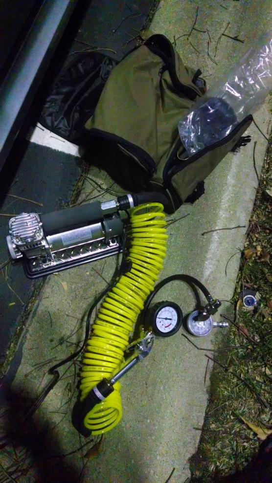

    Here in parts of the Midwest we got down to about 17 degrees overnight and didn't get above 32 today.
    Driving to work, the tire sensor pressure monitor went off in my car. Figured it would go off as I drove, but it did not.
    Get ready to leave work tonight and break out the air pressure gauge. All the tires were down to 26 psi, crap.
    Broke out the VIAIR air compressor, turned on the car and started airing them up.
    Check your automotive air pressure early and often.
    Picture of air compressor
