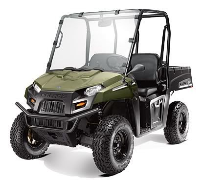

And the Polaris Ranger in the UTV is G2G in my experience. I used one extensively (and abused from time to time) in Iraq and the thing didn't quit. Four months it trooped on like a champ and never missed a beat. And you would be surprised at what you can carry in one.
It all depends on what you want to do with it. The UTV has a lot more potential as a utility vehicle, but is limited by the places it can go so to speak since it's wider than the ATV and has slightly less power. The ATV can get more places and generally has more power, but again is limited by cargo space and passenger loads. Both can use a trailer, both can have attachments (like snow plows and even farming implements) and would be a good tool on a BOL. Although I have to say, an ATV is great for the snow since it's far easier to get unstuck than the UTV. Far less weight to deal with when you are in snow up to the handlebars.
Having said that, depending on the size of the property, I would probably go with the UTV since it does offer a lot more in the way of cargo room and the ability to safely carry two passengers (more unsafely, but we won't talk about that). Overall, it would probably serve you pretty well.
