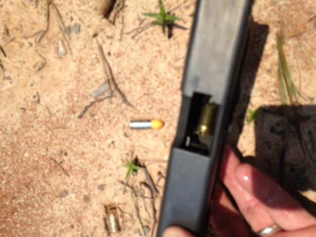

    So, working malfunction clearance drills on the pistol with my son and I started up'ing the ante a bit showing him how to work the same via one hand.

    The problem shown in the pic came up when a spent casing- loaded back in a mag to purposely create a malfunction came through. During the one handed clearance it fell downwards somehow and got mashed up there.
    Ideas for clearing that- USING ONLY ONE HAND. It was stuck in place.
    With enough hand strength one can grip the Glock in such a way as to pull the slide back with the same hand that's holding the gun. I get close with this, but not close enough.....
