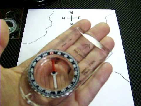

                  Map Compass 101
                  Let's look at the most basic uses of a map style compass and how to use it for simple navigation in the wilderness.
