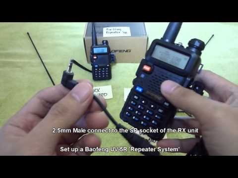

    This video on you tube shows a pretty decent design.
    if you want to go super cheap buy a set of Baofeng uv5r's and place them into a waterproof plastic plano container you could probably get the cost below $200.. It would be wise though to design in a battery supply to boost run time. Also be sure to set a DCS code on the receiving radio so it will only transmit signals from radios with a correct corresponding code programmed in. OR if you are a total penny pincher :cool: you c ould just run a cable from the earphone jack of one radio to the mic jack of a second radio and use the VOX function on the transmitting radio. It will work but you will be lacking some advanced features such as being able to remotely turn on and off the repeater functionality. Which personally I can see tactical reasons for doing just such a thing....
