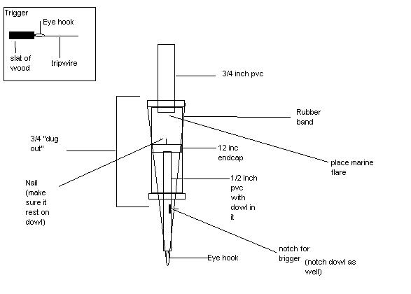

    tried to post this on Jerry D Young's Site but could not for some reason. It is a trip Flare made of common items I worked up a few months ago. I had originally planned to send Jerry several Ideas (Not all of them as that could compromise my security) but some of the more interesting ones. If anyone can let him know about this idea or Jerry If you see this idea you and anyone else who wants to is free to use this for Defense.

        attempt
Name:	trip flare.JPG
          got one to work
            Spero, tell us how it works.
              [QUOTE=cdevier63;57790]Spero, tell us how it works.[/QUOT
              The half inch pipe is pulled down and trigger put in notch. The trigger is hooked to trip line. Trip line is activated. rubber bands pull pipe and dowl forward. Nail in pipe strikes flare primer flare launches. hook to peg or tree and aim up. Simply watch for flare.
