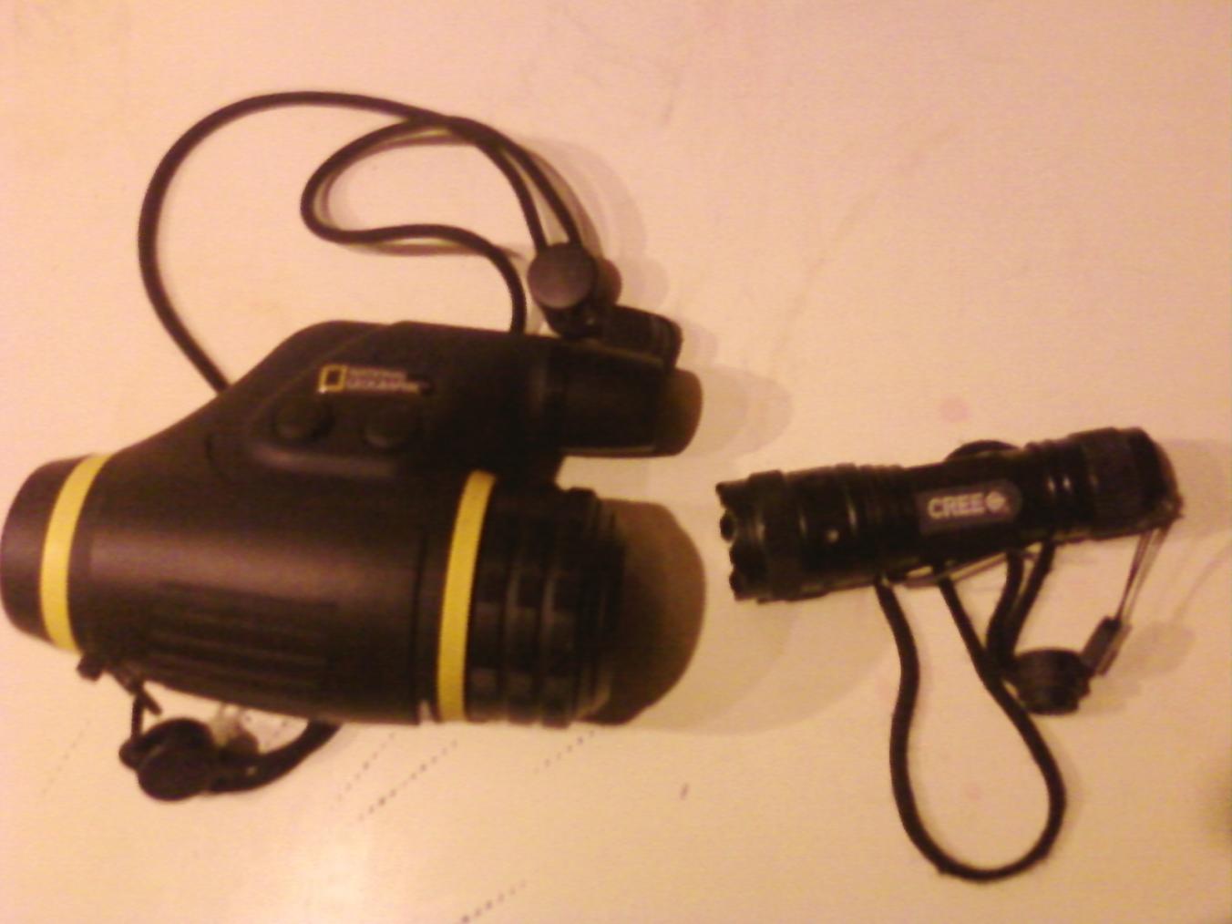

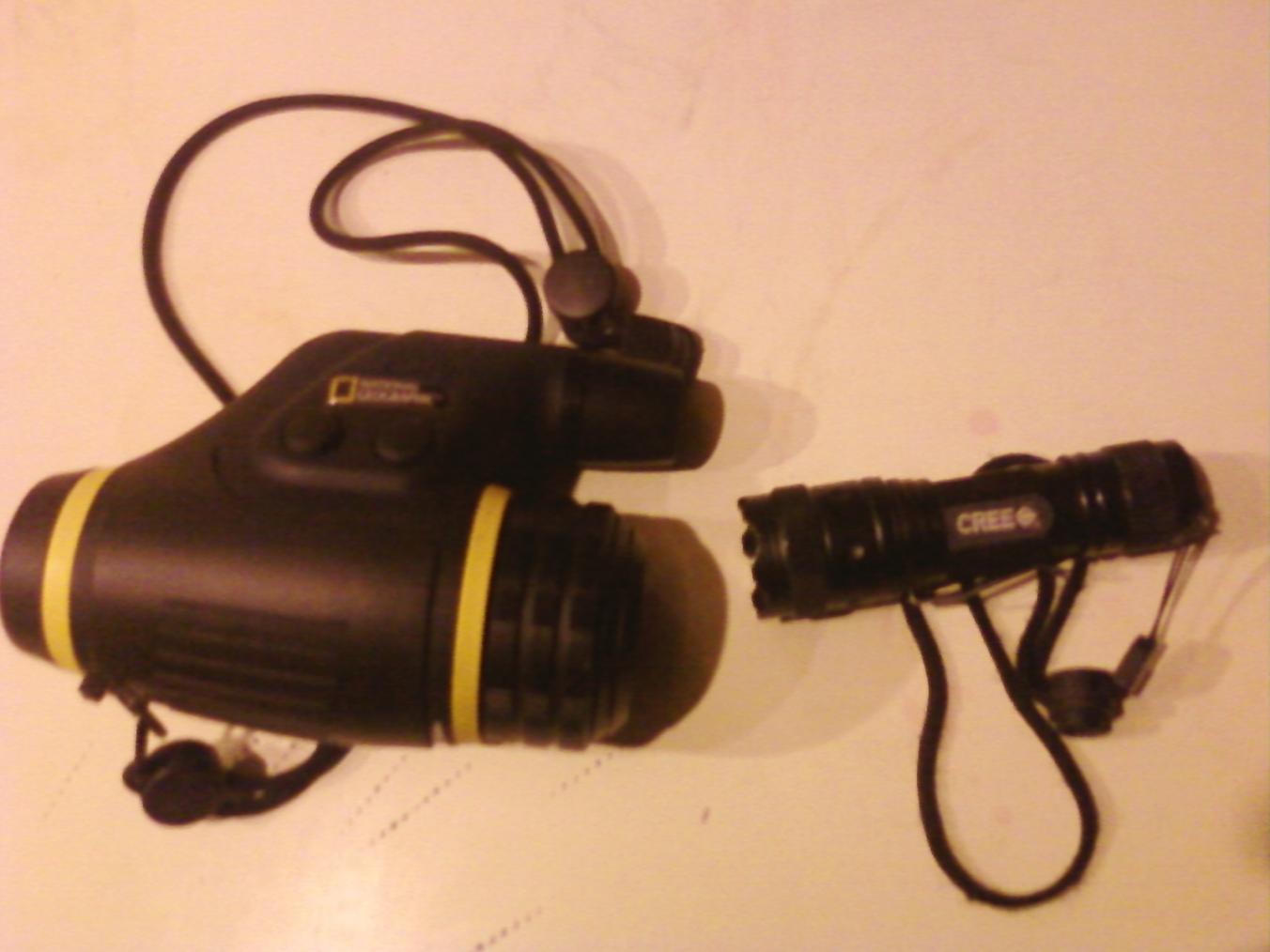

Ok here is your answer to russian cheapies. And before any of you patroitic American shoppers jumps me for having one it was a present from someone and I didn't even know I was getting it so lay down. I used a cree flashlight which I turn on and then change to strobe and turn it towards the unit. I didnt even get it pivioted all the way around before the unit shut down at around 8 seconds. I tried to get the unit to turn back on bit it wouldnt for another 30 seconds which is a long time when things are going bump in the night so again buy quality.
