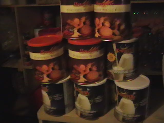

                honeyville is a great company, most preppers have spent hundreds of dollars with them, their stuff is a little higher priced because their shipping rate is only $4.49 on every order no matter how much you buy, so the more you buy the more you save. the other great thing is if you buy like a 50 pound bag of beans or anything and when you open the shipping box and the bean bag is broke open, just give them a call and they'll ship a new bag right out at no charge and no hassel.
                the problem with their #10 cans of corn meal is that the storage conditions have to be near perfect,cool and dry. the other thing is 24 pounds of corn meal cost about 52 dollars compared to 50 pounds of whole corn for about 39. but you can buy whole kernal yellow dent corn locally at a farm store or from a farmer or a feed mill for about 10 dollars a hundred pounds. it's the same yellow dent that is ground and fed to cows.
                i do keep several cases of their powdered eggs and milk though
