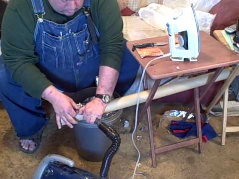

                      Actually mylar bags can be vacuum sealed, they are just not designed to be specifically as vacuum bags.
                      To vacuum seal a mylar bag it is easiest done by "chamber sealers" these actually vacuum the chamber, whiche the mylar bag and its contents are inside, then seal the ends, then releases air back into the chamber allowing you to removed your freshly sealed bags. The down side, the lowest priced chamber sealer is around $3K (maybe you can buy a used one?)...
                      There are also some standard vacuum sealers that have a tube adapter that would be perfect for mylar. But for those of us that don't have it, well see the redneck method below.
                      The redneck method is the one I will be using next packing day I have.
                      You seal the mylar bag, minus the tip of the very end, with a WIDE seal (2-3").
                      You then insert your "shop vac" suck it into a vacuum (this part sresses the vacuum so you will eventually burn out the vacuum).
                      while still on (much easier with 2 people) you pinch off the hole (nice strong pressure) turn off vacuum, seal it, release your pinch point, and complete your 2-3" seal. This is not the specific youtube I watched a month ago, cant seem to find it, but this guy does the same priniciple using a very small vacuum (not recommended by me)... but any who:

                          @Klayton - thanks for the vid. I love finding redneck ways of doing things, saves me a lot of money. Don't know if I will go through all that work when I can just use an O2 absorber and get the job done.
