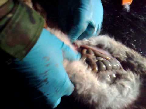

    Great video, I love rabbit, and its some of the most abundant, easy to get and butcher meat there is in the wild.
      Thanks for sharing the video.
      A couple questions: Do you not make more of an effort when separating the vent to not contaminate the meat? Also, he said he saves the hides. Anybody know how to treat a hide for perhaps coat making later?
      Thanks again for sharing the video.
      ~Klayton

              Actually, If you don't care about the pelt you can just pull the skin off easily. No knife required.
                don't give them any water the day before butchering and the sack won't be so full,

                  I was always in the understanding that more care is taken when cutting the vent loose, not just letting it fall into the body cavity to be removed later.... :confused:
                    The only thing I can say is wash it thoroughly. I ve eaten many a gut shot critter with no issues of contamination ever.
                      any comments on my other question????
                      I dunno, I’d never even heard of the vent lol usually just slit the belly then give the guts a good tug.

                        Triple-sod, the vent area is the reproductive organs and bum area (boy/girl parts :o).
                        Klayton- I don't raise bunnies but I rabbit hunt and pretty much follow the steps in the video. I use a knife and don't hang the rabbit because it's so small and easy to handle. If for some reason when I'm field dressing it I nick something or I had a poor shot (more often then not) I just process it completely before heading home (break it down by removing the skin, quater it, remove the back straps, rinse the meet with water and bury the fur with the organs).

                          IMO, people make a bigger deal about tieing off the vent areas than need be.
                          The bladder is a little sack and even when really full, with the rabbit hanging, you can pinch off the top of the sack and cut above it. Do that and you won't see any pee pee on the carcass.
                            Thats the only way I've ever know.
