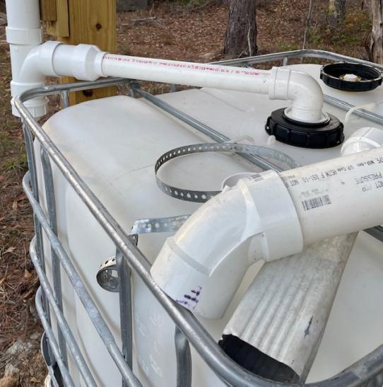

    Click image for larger version  Name:	IMG_7964.jpg Views:	6 Size:	48.3 KB ID:	116340

    To describe what you see/don't see in the pic and set up on the outbuilding pictured- The gutter itself has a mesh gross filter for pine needles, etc. in the gutter outlet. It goes from there to a "leaf eater" type device-
    https://www.amazon.com/dp/B07Y3TZY4Y?ref_=ppx_hzsearch_conn_dt_b_fed_asin_ti tle_3
    which is the last thing you don't see in the pic- opsec being opsec and all...
    Down the 3 inch PVC to the sanitary Tee with the cleanout at the bottom. This acts as another debris catcher and every so often the threaded cleanout screw has to be unscrewed to allow debris to leave the system.
    From there it goes to the tank, hitting one final "filter" type device at the tank itself
    Probably overkill with everything else but worth it. A cover for the tote is not shown but will come in handy as white colored water tanks will suffer a lot of nasty growth in them down here IME.
