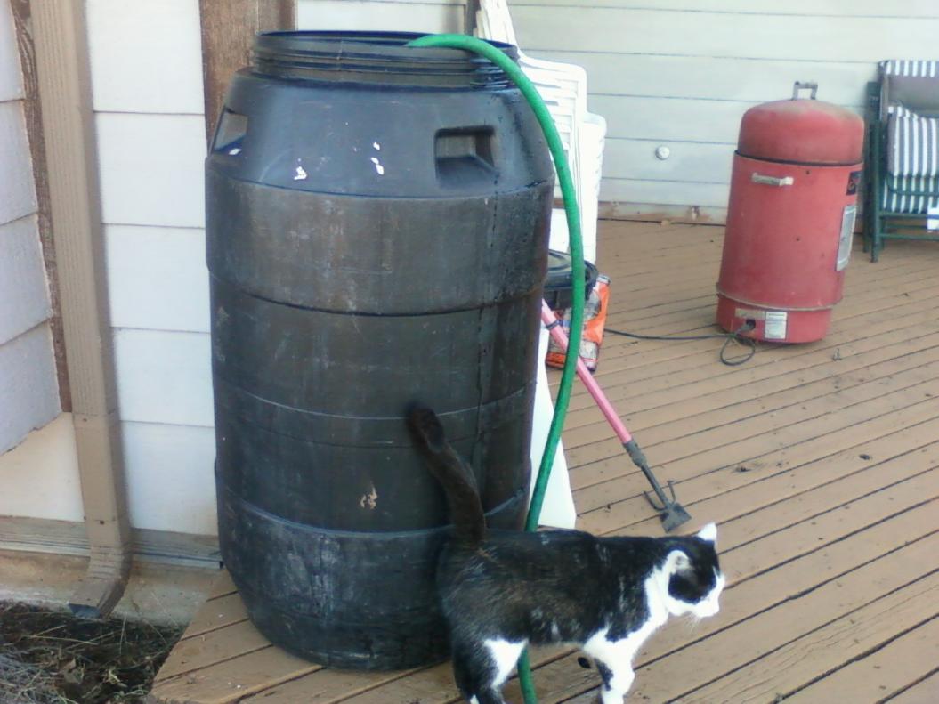

                Put up 55 gallons of water in a 65 gallon drum today treated with bleach. It's supposed to hit single digits next week and stay below freezing for a while so we will see what happens. I only paid $12 a piece for the barrels on craigslist so I won't lose a ton of money if it ruptures. I'll let you all know what happens.

                    Ok we had a week with solid below freezing temps and many nights in the single digits. I filled the 65gl containers up with 55gls. The top 4-6inches froze but the rest stayed thawed. When I removed the lid today there was still a noticable seal and it opened with a pop. I am stoked. I have 2 more barells to finish cleaning then fill. This will be a good start post SHTF or even a wether event.

                        What was in those barrels before you got them? Just wondering. I would use those open end drums to store mylar bags of rice, beans, and wheat. Good score!

                          Pickles - one my very well see that yet! There are more out there on craiglist for my okie brethern
                            We had a nice day and I washed out the 2 remaining pickle barrels and I believe I found the key to the persistant smell, Pool Shock. Good scrubbing afterwards and a few rinses and no more smell other than clean.
