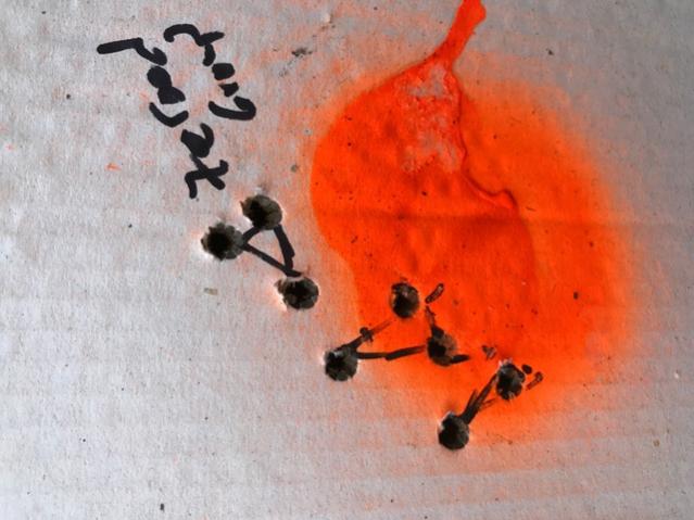

    Various muzzle devices will affect the POI on a rifle. Depending on the type of barrel and various other factors these can be a little or a heckuva lot.
    Had a ridiculously large POI shift on a muzzle device on an AK. However on this Savage bolt gun, the POI change was very little, about 2" at 200 yards. Was zeroing a new scope and noticed it.

    At 500 yards I held at the 500 BDC bracket and it rang steel every time on a full size IPSC target.
    Being as it's not on there all the time, I will just adjust via holding when I use it versus zeroing specifically for it.
