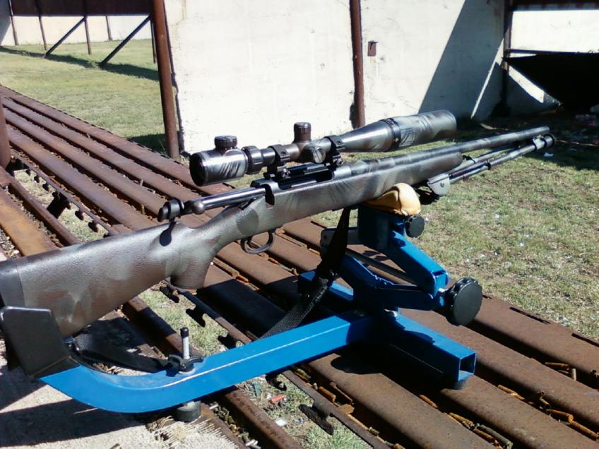

    Ok you guys got me and my son motivated with your fancy AK paint jobs! I have a Remington model 710 that I was considering doing. We used the high heat base coat and my son then stenciled patterns using pine needles, elm and oak leaves. Since we had it apart I freefloated the barrel before he got started. I took it to the range today and was pleasently suprised with my group using factory ammo, winchester 165 grain, at 100yds off a benchrest. I normally do not shoot off one but I wanted to see what the difference was. It was 3/4 inch tighter. :cool:

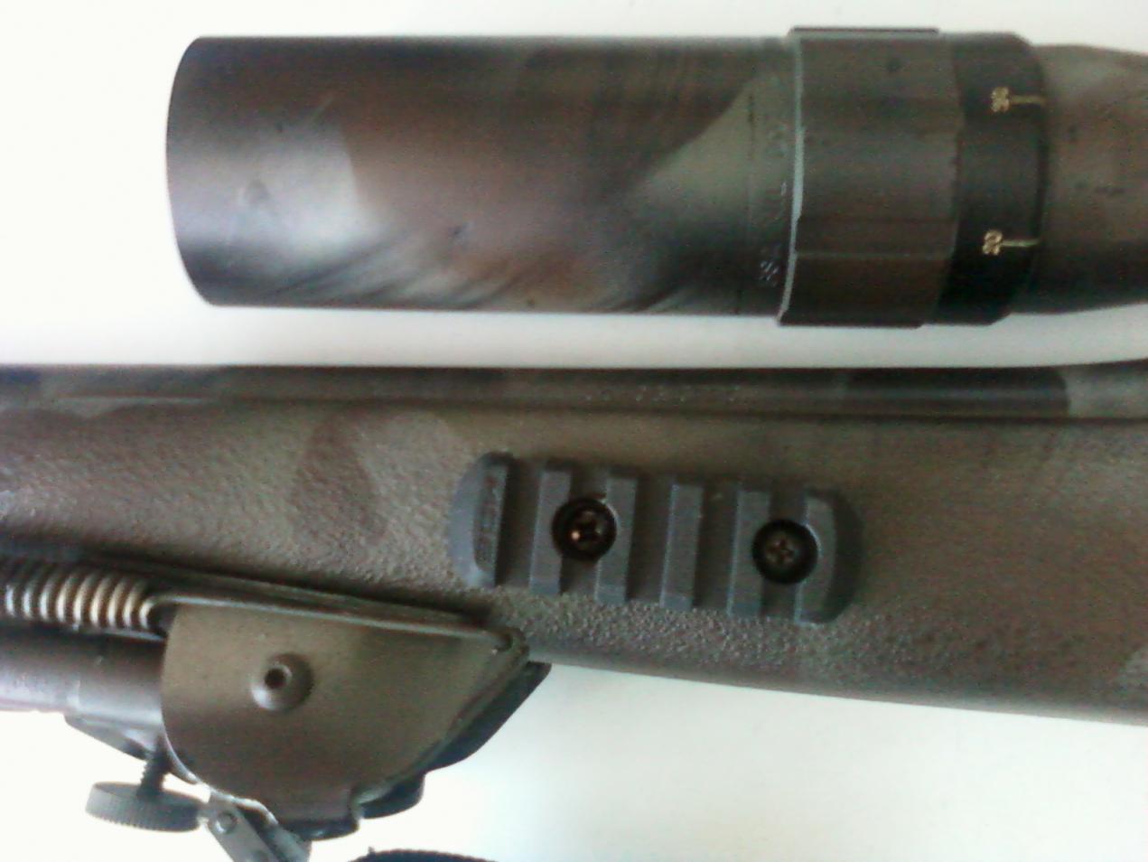

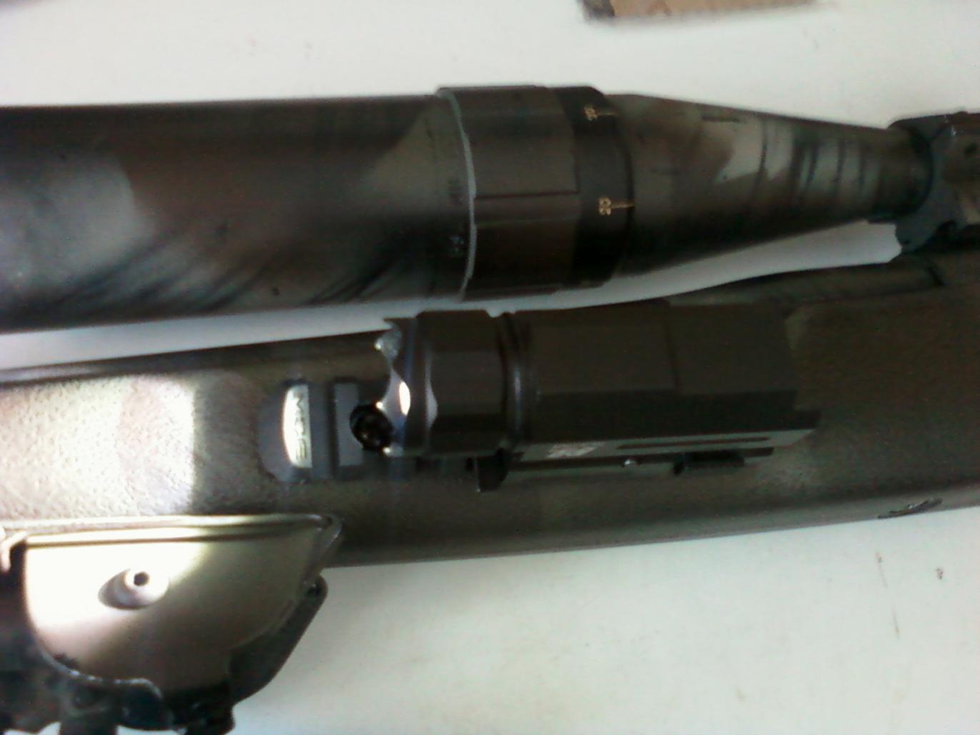

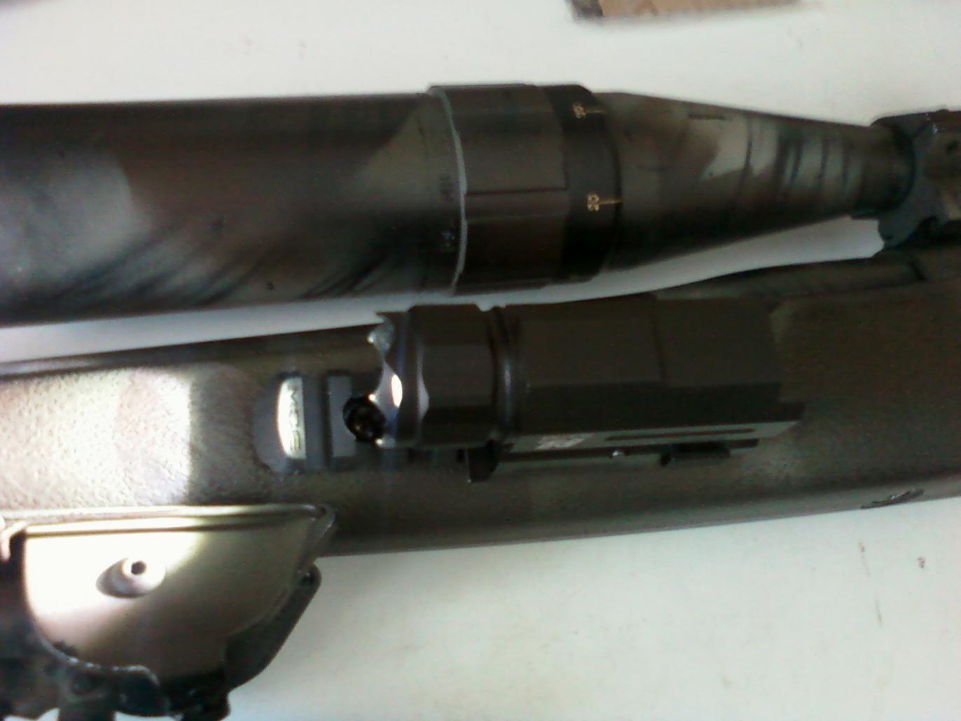

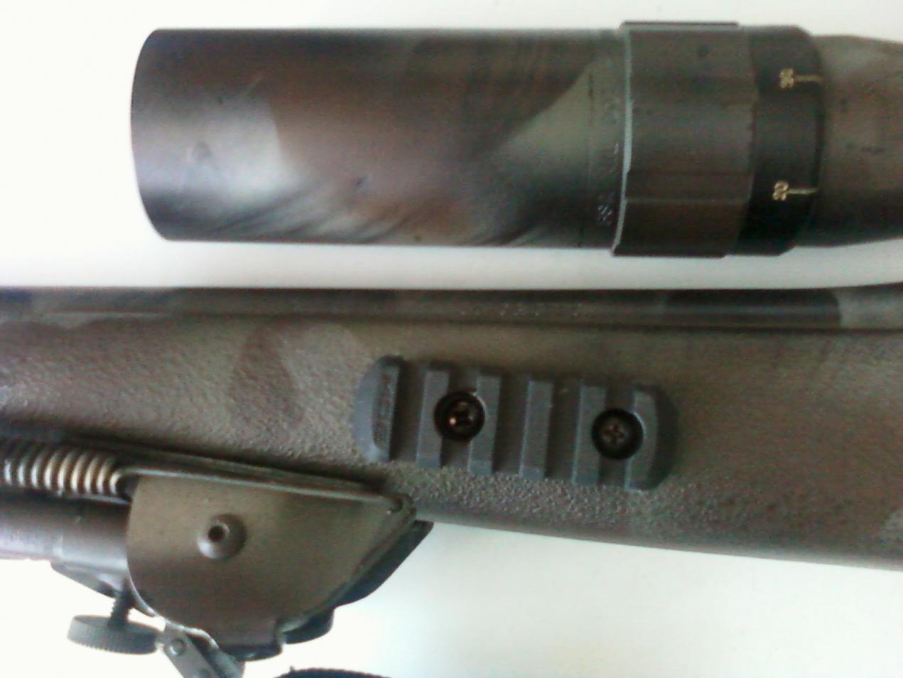

              Made an addition to my 710. I decided that since I do hunt with it alot and/or have it with me at different times it needed to be slightly more capable ya know just in case.
              I added a small plastic rail
              for a whopping $6.93 and free shipping and minimal weight addition. Takes a matter of minutes to place, drill and set. It's "illegal" to have a weapons mounted light for alot of states with current game laws however nothing prevents you from packing one in with you in case things go south while your out. Ya know zombies n stuff LOL or things that go bump in the night. Just watch where you drill and make sure you dont get into the barrel or stiffening hardware and after your done double check the zero.
              Anyway its a cheap, easy project that is very doable for varied skill levels and doesnt require a complete stock replacement as many a salesman will have you believe.
