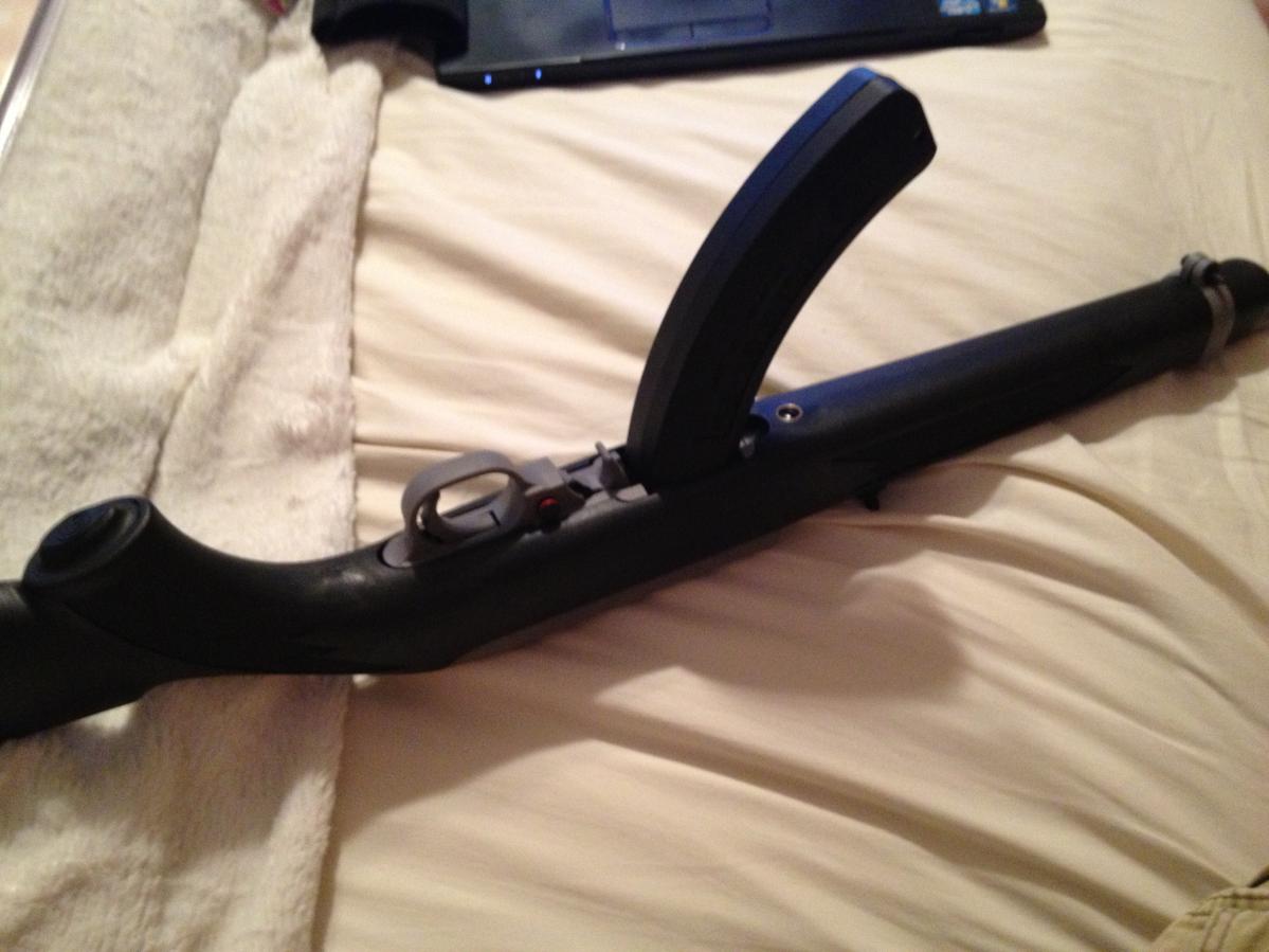

    Folks, before I tear something up, I have a question.
    I have a set of Uncle Mikes quick detachable swivel bases that fits most rifles, they are wood screws. Got a new strap today that I wanted to put on the .22.
    Will it hurt my non wood Ruger 10/22 carbine if I drill the holes and install these? Its the black synthetic stock.

    Hard to answer that without looking at your stock. It depends if its hollow, partial or solid. What synthetic stock doesnt have swivel holes predone?
ID:	107406Here's a pic, butt stock is hollow, seems thicker down the barrel.
        I didnt realize it didnt have the holes until a week after I bought it. Just now got around to getting an extra strap. I cant go up against the bad guys without me strap.
          the solid part will be ok but i have doubts on the hollow section and dont want to steer you wrong
            well if your worried about the butt end, 550 cord that end. and just install the front one.
            or drill as close as you can to the end where the plastic is strongest.

                  Not sure how big the screw is but if it is standard sized then drill a 1/8" hole where you want the stud to be. Make the hole only as deep as you need it to be. Put a little dab of your preferred epoxy (two-part or standard) on the end of the stud and threads and screw it in. Allow at least a few hours for it to set up before attaching anything or moving it any. Overnight would be best.
