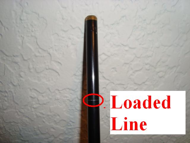

        Here is my rod that shows the loaded line.
Name:	DSC04221 shown.JPG
        Unless you are just trying to stay traditional i also shy away from wood rods as they can splinter and leave nasty things in your hand. I stay with aluminum but do own a few fiberglass but really dont like them.
