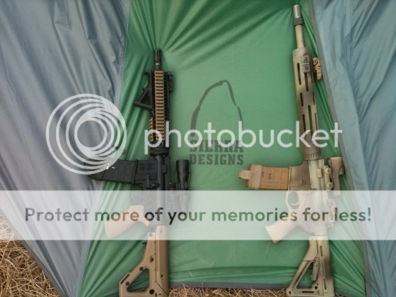

        Here she is wearing an acog I was playing around a bit with. Thats a 14.5 inch barrel next to it.
