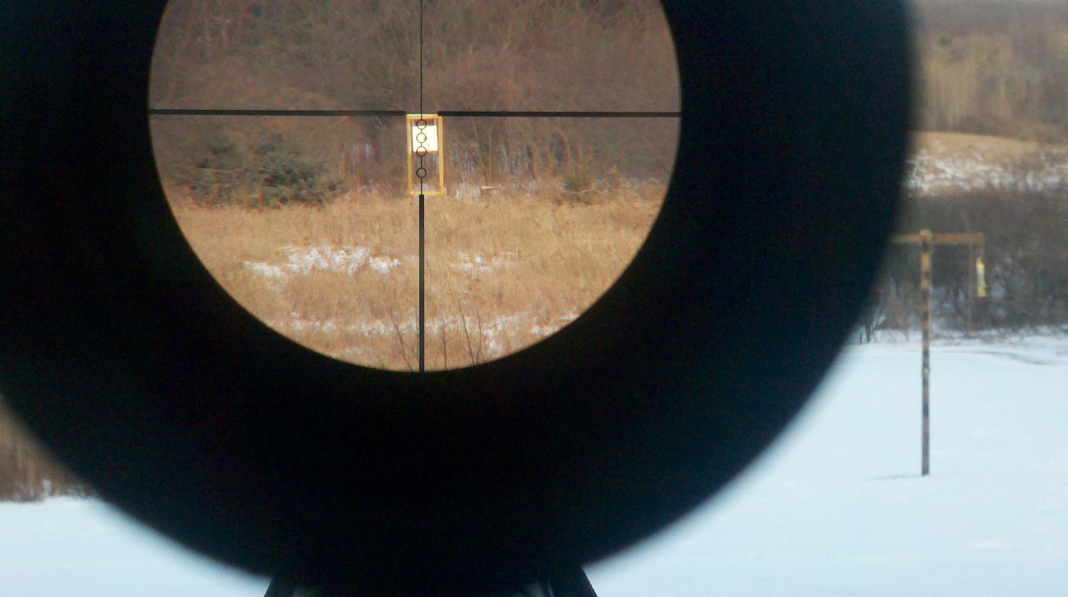

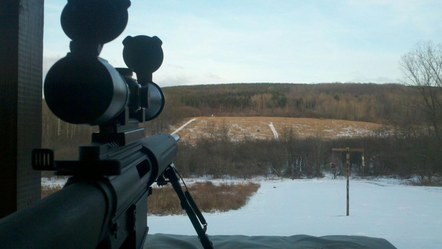

    OK I have had this bug for some time now about learning how to long range shoot. I found a guy who just happened to be right over the hill from me you does this all the time (does the whole comp thing) any ways I bought a DPMS LR-308 and put a Nikon Monarch 3-12 scope on it. So the day came to get it sighted in and I was like one of my children on CHRISTMAS day could not wait and didn't want to end. Showed up to his house set all the good up and class began. He was great what a teacher. I never got the whole MOA thing until now( took like an hour of me asking questions). He keep saying trigger control trigger control. ANYWAYS! We sighted it in at 100yrds and I was laying down 1" groups. Now mind you I have shot 100 yrd before so this was no big deal When he said do you want to shoot the 550yrd target. DAMN right I do. So we talked about the MOA again. So be because of the distance and the wind that we had to deal with I had to go up 13 MOA and R MOA and was making a 12" group. The ammo was Rem 150gr core-lock. I relay don't know what more to say other than you never know what is just over the hill
    Pic 1/ gun and range
    Pic 2/ me taking a pic through the scope
