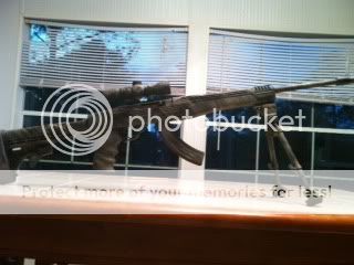

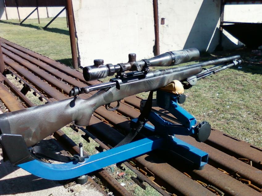

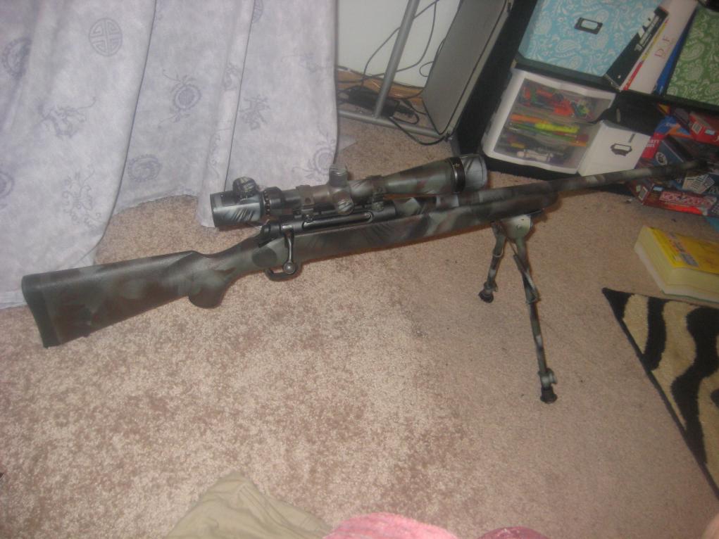

    Hey go with krylon fusion I have used on a 30-06 that is mattinoklahoma's what you need you do is buy the krylon fusion black after you have prepared the frame for paint spray 2-3 coats on the frame. The first coat should be a light coat just enough to lightly dust it. Then cover well with 2 coats. Once it is covered with the fusion black use your choice of Color and cover till black is no longer visible. And you will be good to go. Mattinoklahoma is going to post up pics of his .06 I did and its been tested in the field and help even on rough areas. Any questions let me know
      Sharpshooter is going to respond and I will show you the rifle he did for me. It has held up very well and I dont baby my stuff.

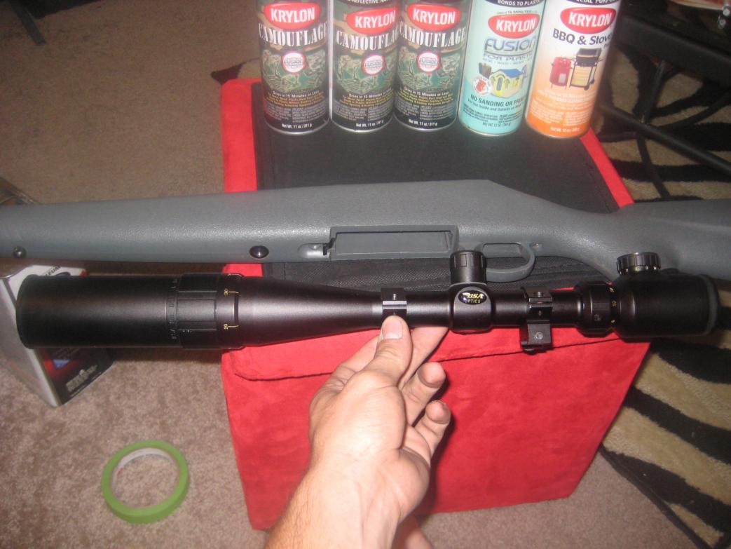

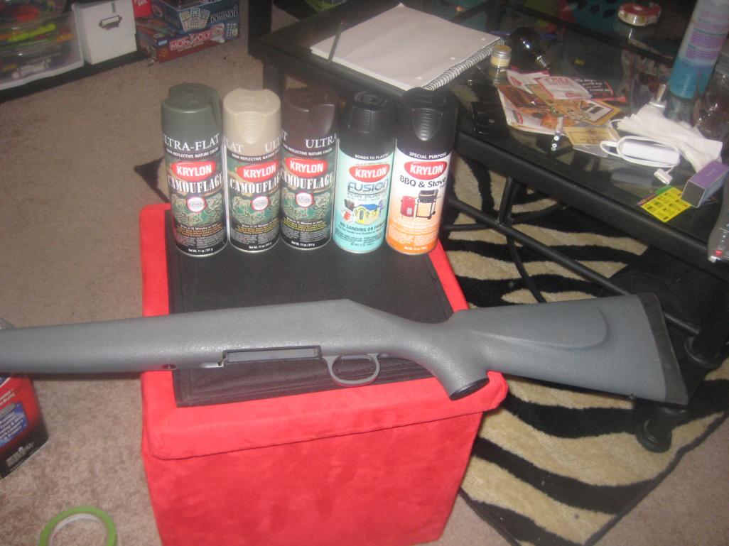

            The krylon fusion is made for plastics or synthetics. The rust o leum is a good choice for the metal but I would suggest using the krylon BBQ and stove paint as I did as your base due to the temperature increase from heavy fire cycle. You need a high temp paint as a base once your have applied your bases such as the krylon fusion and BBQ/stove paints you can use any type of paint to spray over it. Its just essential that your first coats get a good adhesive to the surface of the object.

                    a friend of mine has done 4 guns of mine and they all look awesome. He did my 30.06 3 years ago and when I looked at MIO's version I thought they were the same rifle. Only things on mine different is the scope on mine is black, and the flora in NC is different from OK. He also did two keltec sub 2000's for me and a saiga 12. The 20 round mag on the saiga looked the best. and I say looked, because in my infinite wisdom I traded the shotgun for a popup camper. krylon is the way to go. If you get a scratch in it, just hit the gun with another coat. cant do that with duracoat. Just make sure you dont use the cheap spray paint. Fusion is the way to go.
