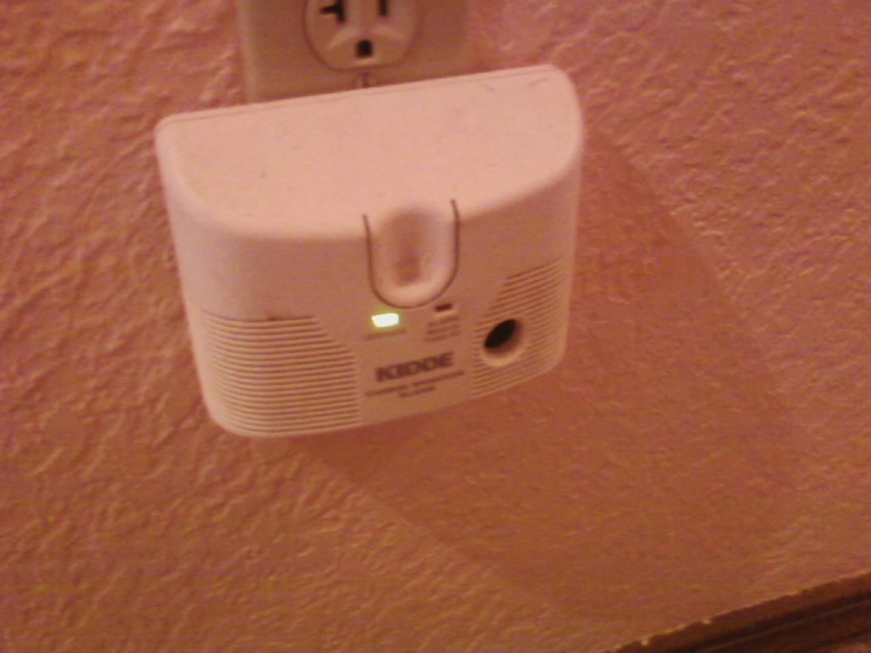

      There are VERY INEXPENSIVE CO detectors out there. In our old farmhouse we had one in every room approx 3 feet from the smoke alarm.
      People, this is just common sense, and stupidity if you don't have these and have open flames in your house. Of course, a fire extinguisher should go without saying, but hey, lets say it. Indoor Fire = CO detector & Fire Extinguisher
        I used to have a double fireplace. One side in the living room, one side in the family room. Apparently, the fireplace was improperly designed, and I and my husband experienced a 'mild' case of CO poisoning. There is no way to describe the feeling. Had not my loud alarm sounded, who knows what would have happened. We were both so sick. The headache is terrible. The nausea isn't like just being sick, it's like you're entire body is involved.
        Get a CO monitor, it's worth the price.
          One other thing. CO is apparently heavier than ambient air, so put the CO detector close to the floor, rather than up near the smoke detector.
            I believe CO is slightly lighter than air. The molar mass of CO is 12+16 = 28 --- When you figure air 21% O2 (16 x 2=32 x .21=6.72) and 79% N (28x.79=22.12) this equates to 6.72+22.12=28.84 or so. (I'm having to do too much chemestry this late so my math may be off). Now they are very close so they will mix quickly, but the CO is still slightly lighter. Now, physics class was a long time ago, but temps and humidity may play a role with these numbers.
            I have always been told to put it at least 6 foot up. I don't know where I heard this, maybe on the box mine came in.
              To put it in slightly simpler terms, the vapor density of CO is .97. Air is 1.0. Anything less than 1.0 is lighter than air anything greater than 1.0 is heavier than air. So while CO is slightly lighter than air, its density is so close to air that it easily mixes and stratifies with ambient air.
              Heated CO will rise but the heated currents that carry it will mix throughout the room thus negating the effect.
                Thought I'd bring this post to the forefront. I just inspected my furnace (preparing for winter) and found a rust hole in the chimney pipe. Replaced the section of pipe and checked my CO detector. The instruction manual (yes, I still have it after all these years) said that it was good for 10 years and then should be replaced. It was 8 years old so I replaced it.
                Question is, have you checked the 'expiration' date on yours lately? They will probably work past the recommended date but they're not that expensive and I don't want to take the chance.
                  DO NOT depend on CO detectors. CO is a cumulative problem. A small amount that doesn't register on your detector will still kill you over a long exposure period. The inexpensive detectors (non-laboratory / home monitors) only catch large fast amounts of CO but don't register minor amounts. Normally these minor amounts won't hurt you in passing, but they will kill you if they are in your home and you are there for a majority of your time over the course of a month or so. CO bonds to hemoglobin 10X better than Oxygen so oxygen doesn't displace it well. Think of an airport; when all the gates are taken up by empty airplanes CO, clean airplanes can't dock and discharge their passengers - oxygen.
