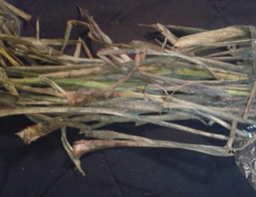

      Here is the leaves I take from the plant. I try to get the ones that fall closer to the ground and are ready to fall off. You can use fresh or old, as long as not rotten.
Name:	Rope plant 5.jpg

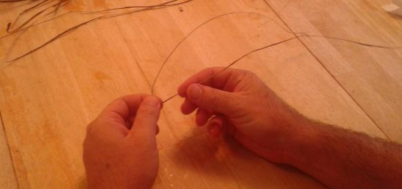

          Break down process-
          first the material will be strong you can not just pull it apart.
          Her I am trying to show me pulling hard on the plant. I have also tied my hands behind my back and in front and have been unable to break thru. I don't think I have that much pansy in me either. :cool:

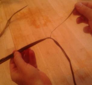

          then once you find it a stong plant/bark you start to break material down.
          Till you get to something like this, Remember that this has plant fibers on it and will fall off over time.

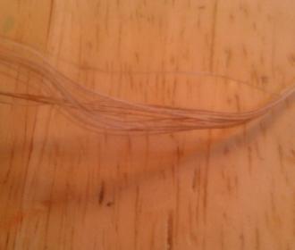

            A look at all those tiny fibers that make the rope.

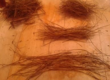

            All done with this pile.
            the top left is waste probably go into compost. The very top is the small pieces that I will try to make thread and such, never done before so I will post my results. Middle and bottom layers the 2 longest will be put to use for general purpse rope making.

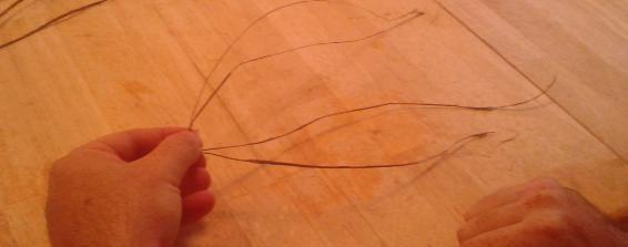

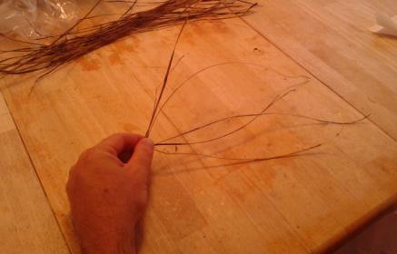

              OK after you break down your material then it is time to start making rope. I will do little parts.
              get three strands that you want to start out with. This will be a good size round for general rope.
              Bend your frist strand in a U shape
              Second strand in a U shape, but this one a little off kilter on the tips like shown in picture. So they will not line up.
              Now the third one a little off then the first and second one. Basicy a inch or two off from the other ones. this is not set in stone so it des not have to be perfect.
