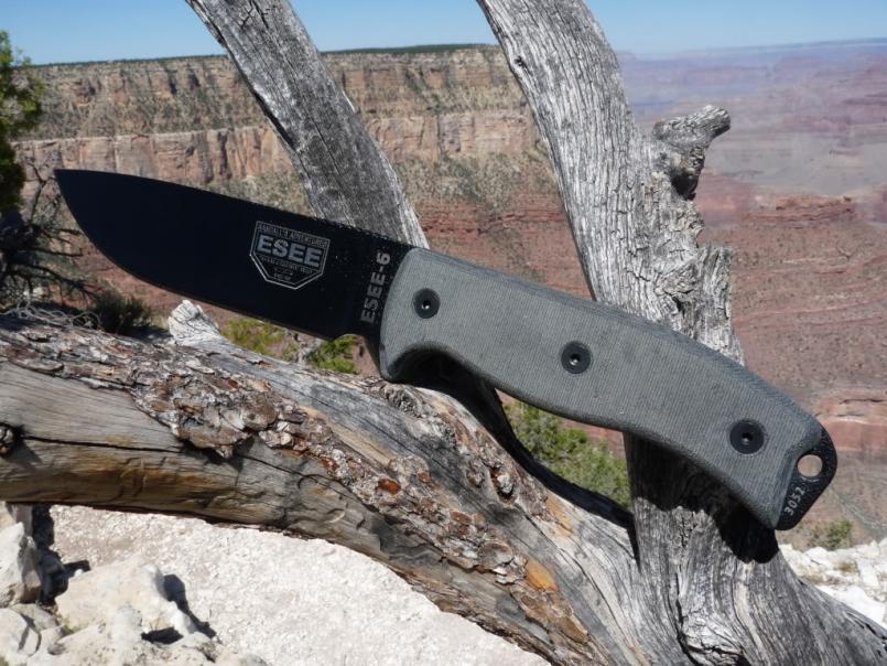

              ESEE-6 is a good all around knife for SHTF. You can choke up on it and do fine work, or use it as a chopper or baton with it and if needed could be used as a defensive blade. It can be sharpened easily in the field if you know what you are doing. It is very well balanced and ESEE knives are guaranteed for LIFE of the blade. It can be passed on to children and grandchildren and still be guaranteed.
Name:	ESEE 6 in tree.jpg
              [URL="http://www.eseeknives.com/rc-6.htm"Randall's Adventure & Training
