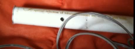

    I needed a "fixture" to hold the bulb, do you know where to get Aluminum Cigar Tubes?
    OK, so notice a few things:
    1. the opening is "belled" after I cut off the threaded area, if your tube has no threads, better yet! I simply used a pair of Needle Nose Pliers, to bell it out a bit, makes it easier to insert.
    2. I cut/drilled a hole a ways back on the tube, just an exacto knife, nothing big time about it.
    3. The wiring is shown, just to give you an idea of what it was, and that it has polarizing print on it.
    The wire came from a dead wal-wart, you know, reduces power to plug into a toy, phone or whatever. I never throw wires away ... I always have just the particular wire for a job!

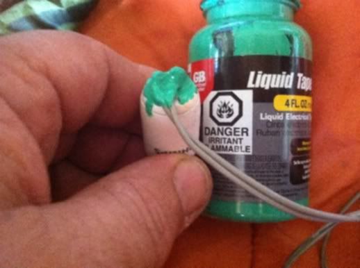

    Now lets assemble a totally waterproof lamp holder:
    I am using liquid PVC in Green because it was close to my reach, and I have lots of Green. I save Red for 12V DC positive work, and Black PVC for negative work... I also have White you will see why in other DIY projects.
    Here the Light is fully installed, and sealed again!
    You can also see, that where the wire comes out, is also sealed with Green PVC!

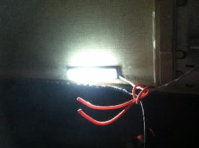

    Clean the lense up:
    here it is, pitch Black, and just that LED "on".

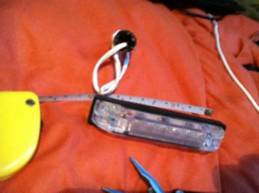

        Here is my "Light Number Two"
        This is a stock part found in any good Marine (boating) Store.
        In its photo in the first post, there are Red Arrows pointing to the six LED bulbs, full encased with a plastic case, and Epoxied on the bottom side.
        It comes with a pigtail setup, that makes it simple to do, Red/+ Black/- doesn't get easier!
        it comes with a nice rubber mounting setup, which is great for boats, not needed inside an RV.
        I tried to show size, here is a better take on it:
        my 4 inch calipers. It stand 3/4 inches tall:
        Hey, there is that Green PVC again!
        I buy it Cheapest at the big Orange BOX store lots of us use.
        To my surprise the most expensive place was Harbor freight! by almost Twice the cost, but a "metal can" not glass jar, both have a brush on the lid to apply the PVC.

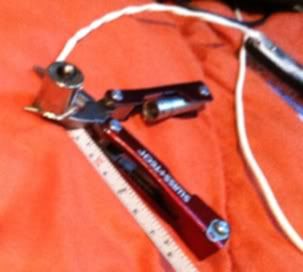

        I had a broken tail light bulb, and broke out all the glass, soldered the + lead to the center, and the black lead to the brass base.
        Now it just plugs into the regular socket that 100 percent of all RV's have... !
        The multi-tool is my favorite for this work: Swiss Tech, about $10. spring loaded handles in pliers mode. and hard to give "to much torque" when you use them, strips 20 gauge wires easy, etc.
        Here it is, plugged in, again pitch black, to show its capabilities.
        ??? What is the Orange thingy, philip ???? Oh some 550 para cord, international orange, gives a good idea of color balance.
