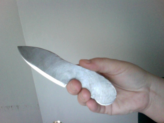

Here's my latest project. Cut this blank out of a saw blade. Going to make the handles from oak and use brass pins and epoxy glue to hold things in place. Well that is the plan. I broke two carbide bits trying to drill the metal.. might heat the drill points to cherry red and let cool, this should soften the metal.
Working on making a knife out of a saw blade

If these blades you plan to use are hard enough to make a good knife you are going to have a hard way to go to shape and bevel the cutting edge and will have to use carbide drill bits to drill holes for handle scales. If you can drill it with regular drill bits it is not hard enough to make a good knife.Originally posted by rice paddy daddy View PostI've got some old 10" circular saw blades from work I wanted to do this with. I feel encouraged now.
I've also thought about using lawn edger blades.
I know nothing of metalurgy, heat treating and such. Nor do I have a forge.A mans quest for knowledge is his greatest asset.
