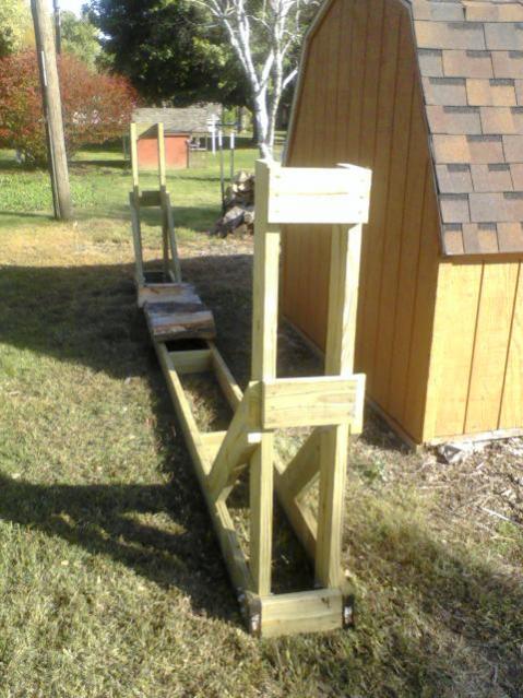

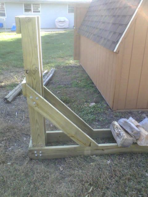

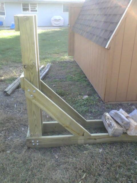

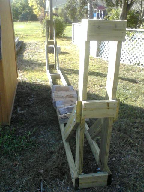

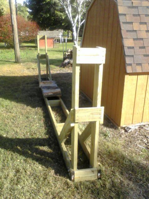

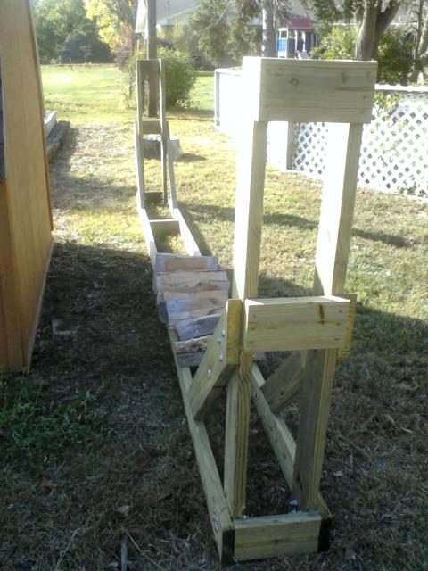

So my wife got tired of looking at the fence post firewood rack that i had been using...so i drew up some plans on MS Visio and built my own wood rack. treated 2 x 6's, 1/2" bolts, 7/16" bolts, and lots of screws. Here are the pics. As of this writing I still need to add trussel straps to the 45 degree angle that meets the bottom 16' 2 x 6's. I didn't have any at the time so I just put the wood in the middle and didn't put any on the ends that might put pressure on them until i had attached the straps and screwed them.

Width is 14", length 16', uprights are 5'...I have viso drawings if anyone wants them.
