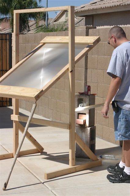

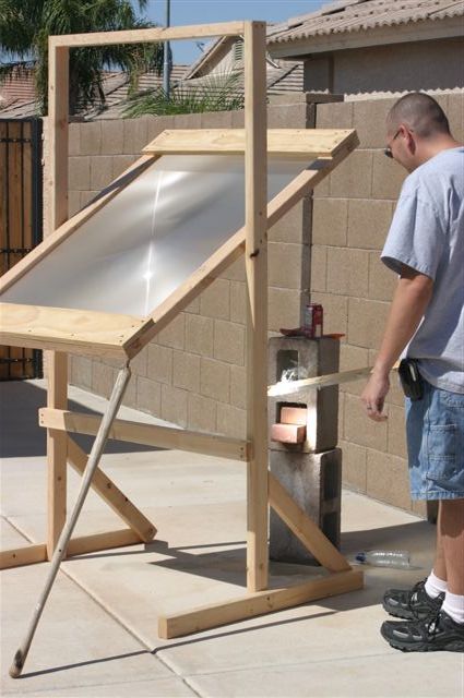

    If you place this lens into a wooden frame and place it in the sun it acts like a magnifiying glass and can reach 2500 degrees. You can now boil water with ease or start a fire, melt metal or what ever floats your boat. Now you can get the mirror that is located on the back of the TV and then place it on a flat surface and then place a rack about 8 inches above the mirror. place a pot or pan on the rack and bounce the beam off of the mirror and on to the bottom of the pan thus cooking or boiling anything you want. I have 4 of these Lens and got three of them for free from people who were throwing the broken TVs away.

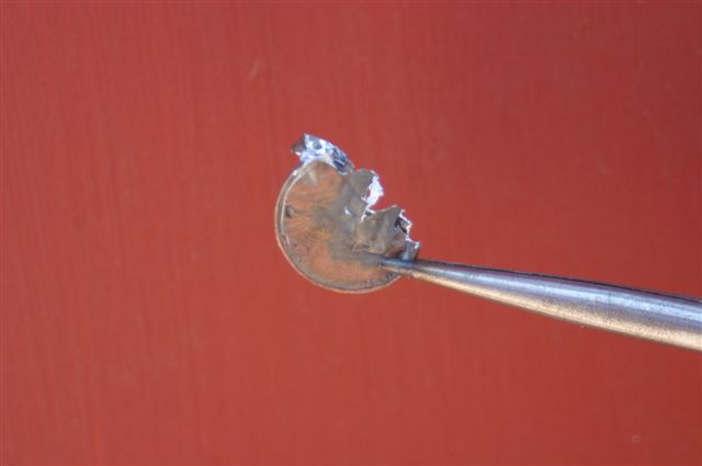

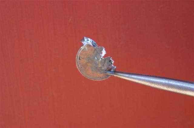

    It takes 787 degrees Farenhite to metlt a 1982 or newer penny. It took less than 30 seconds to melt the penny.

    It comes down to this: If you are without power and running water but the sun is shining then you can cook or boil water with a free source of energy and save your other resources for a rainy day.
    Cool idea...no pun intended. Is there a concern of melting a hole in your cooking pot?
      With this you can boil water in a coke can. If you placed a empty can in the beam then it will melt. If there is water in the can, the heat will be transfered to the water. I have even boiled water in a plastic bottle. The bottle warped and after the water boiled for a few minutes then the bottle melted. If you focus the beam where it is not in perfect focus you can keep the tempature around 300 to 500 degrees. At the focal point is where you get crazy tempatures.

          Here is an example of the Fresnal lens starting to boil a pan of water.
