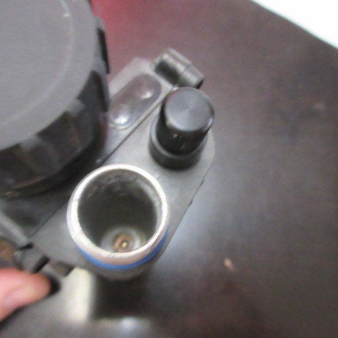

    Take the battery out when your done- EVERY SINGLE TIME....
    This guy didn't. We mention it in the "Quick user guide" you get when you are emailed your tracking. It's mentioned in the paper work in the bottom of the box. Yet it still happens. It's not covered under warranty, no one covers that under warranty.
    Estimated cost to fix this can be from $300. to $800.
    See why you want to get in the habit of taking the battery out?
    Every. Single. Time.
