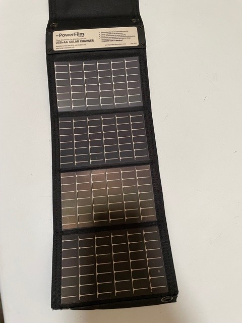

    Inexpensive solar battery charger that folds up that you can find on Amazon.

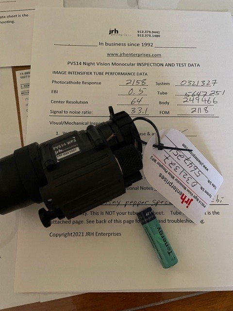

    Showing the rechargeable batteries.

    Showing battery and test unit

    Why show these pics? Because it's commonly believed by some that NV "won't work with" rechargeables. But keep in mind it's just BS from various companies that would have you believe that so you don't try to use them.
    Once again, to be crystal clear- I am NOT making a statement that you "should" use rechargeables or that they are "ideal" or anything stupid like that. And yes you could possibly void your warranty using some Chinwaaachoo chinese crap rechargeable.
    But as a survivalist, it's important to KNOW what you can do with your gear- and having RECHARGEABLE batteries for your important electronics is critical to that.
