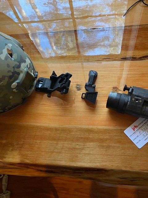

Even though it should be obvious, for clarity the helmet is the FIRST item in the pic going left to right, the "shroud" is the piece front and center.

So here is the pic. Left to right- 1. Helmet with NV shroud on it. 2. Norotos Lo sto helmet mount 3. AX14 PRO articulating arm 4. PVS14.
And after having a rather insane guy call yesterday and argue with me that he didn't need a helmet mount (item #2) after telling me he didn't have any of these components, let me be very clear, you need EACH of these components to helmet mount a 14. There are different options for each components but the basic components of 1. Helmet. 2 Helmet mount 3. J arm 4. PVS14 remain the same and just having a 1 Helmet and 3. J arm WILL NOT WORK. If you don't know, just ask, but screaming at me won't get you a nice answer :)
