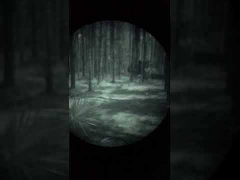

              Another happy customer and a GREAT COMPARISON article from someone with a lot of experience in Night Vision!
                Been some BS put out on the web that the "ECHO spec units don't do well in low light"
                Really???? Well let's just see!! And because we LIVE IN THE WOODS, not in some California suburb we take our NV pics and videos IN THE WOODS, you know WHERE IT'S DARK!!! Meanwhile the idiot that claimed these don't do well in "low light" loves to post pics of NV units being used in city and suburban environments where you CAN SEE THE AMBIENT LIGHT off the of McMansions, the STREET LIGHTS and hell even sidewalks!!
                Here's a clue folks- if you see SIDEWALKS in a video or pic touting how well a Night vision device does, understand that they are purposely taking those pics in a HIGH LIGHT environment to make their units look good!
                Here is how a Photonis ECHO spec White Phosphor unit does in a TRUE "LOW LIGHT" SITUATION- not on some schmuck's porch or sidewalk in suburbia!!!!
                  If I didn't already own a PVS14 that I purchased from JRH Enterprises, then these would certainly be on my list of items to get. Definitely a force multiplier.
