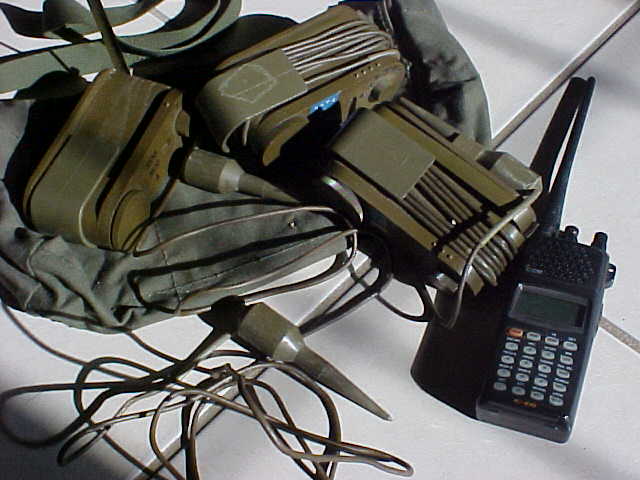

    The wireless sets operate via a seismic probe attached to a transmitter unit. The antenna is a military flexible metal tape type setup- similar to a tape measure. I've seen ONE of these break and honestly- I clipped it with a bushhog. :mad: Keep in mind these are military units, not any hokey jokey civilian or cobbled together whiz whiz wooo wooo "personal alarm" type BS. In other words, they are waterproof and designed to be left outside in ALL weather conditions for long periods of time.
    The transmitter on the wireless probes has a selector that reads 1,2,3,4 and 5. Not sure what all can be seen in the pics. These settings of 1 through 5 denote the RANGE of detection. Setting "1" is essentially point detection. Say you wanted to detect intrusion JUST at your gate, this would be the setting to use. It goes up in range from 1 to where 5 is the most sensitive and that usually equates out to 30 yards or more from the probe/transmitter.

    We test every set we get. Sometimes a "set" will contain 2 or 3 probes, sometimes all four will be present and working. Unfortunately it's about 12 years to late to be picky.....
    Attached are a pic of the TRC3A set, this one has 3 probes. The R10 does not come with the set :)

        Simplest test is just setting them up. Their is more advanced tests you can do also that will give you a handle on things better than that.
        For the wireless that means putting 2 nine volt batteries in the transmitter, sticking the probe in the ground, setting the sensitivity level and listening tot he freq listed on the transmitter to hear the tone.
        Their will be a different tone for each probe 1 through 4, denoted by a single beep, double beep, triple or four beeps. If you look close on the transmitter body (not the probe the transmitter), you'll notice either 1, 2, 3 or 4 small bumps molded into plastic on the top of the transmitter. This isn't brale (sp). This is for when you are setting them up at night. You can run your finger over each probe and know that probe 4 is being set in this spot, or probe 2, etc.
        That's the other advantage of the wireless over the wired that I should have mentioned- you know immediately WHICH probe is detecting without having to play with the receiver to find out.
