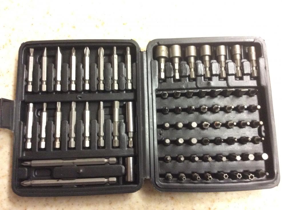

      I had a family member with car trouble a couple of years ago and went to help. Short story, ignition switch, not the key part, the electrical part was bad. Lowered the steering column to find that it was attached with tamper-proof torx bolts...the only tool that I didn't bring. Off to the parts store to get the switch and a socket. Instead, I purchased a magnetic bit kit for $9.00, picture attached. It even has Robertson bits that the camper uses. What it doesn't have is the drive that you saw, which is a clutch-head. It looks like an hour glass and was used on old Holly carbs. Click image for larger version

ID:	108079 I highly recommend all have one if only for the torx bits. Cheap insurance.
