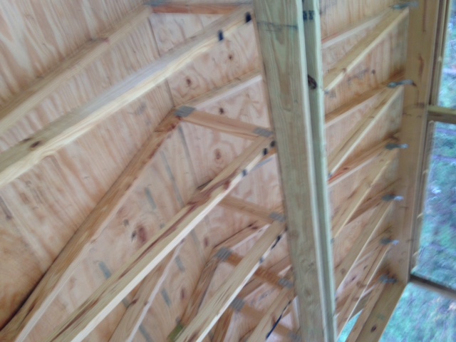

            Putting roof on this weekend, hung the trusses today by myself. Added a double 2x8 girder down the center of the building under the trusses. Whenever I hang a deer or other animal, this will give us plenty of strength, plus give extra support for the roof.

              About the only angle I can take of this building without ruining Opsec. It's literally near "everything", most of which I'd prefer to not be seen forever on the internet. You can see I'm not THAT bad of a carpenter. First time I've set trusses completely on my own, but thankfully they were only 16 feet with a low pitch.
              The double beam is for hanging animals. I have a 12vdc two thousand lb. winch coming with a remote. It will be mounted up in the double beam and should support anything I will butcher. I'll be able to back a vehicle right up to this building also. Conceivably I am cutting down on a lot of grunting and heavy lifting now when butchering.

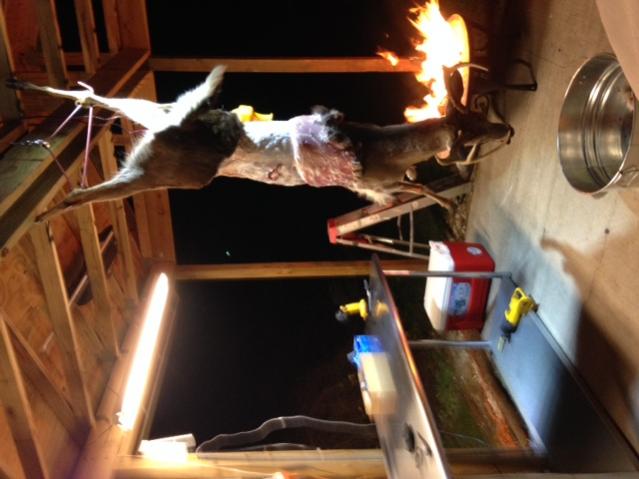

                It worked out pretty well first go around.
                Midnight, coldest night so far this year here. Roaring fire in the little fire pit deal, plenty of lighting with the 12v light bar and the 110 shop lights.
                Winch worked great. Nice working height without a lot of grunting.
                Only thing I will change is we will run a garden hose up over the rafters and set up to hang down if need be. This will make hosing it out easier and also cleaning the table easier.
                The table itself was bought off Amazon. It's not bad, but not as bomb proof as I would like.
                I was able to lower the deer over enough to swing it up on the table right from the winch.

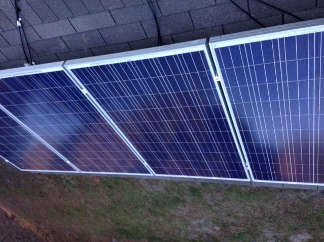

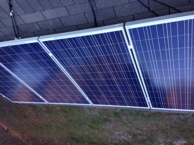

                  It's continuing to come together. Have this same array on the other side of the roof also. For best winter use I think I'm going to have to take out a few trees that I've trimmed a bunch trying to keep. Used combiner boxes this go around. We didn't have that kind of cool daddy stuff "back in the day" and we used to just tie all the positives together on one big electrical lug and all the negatives from an array all together on another big lug , each tied to a larger gauge wire running back to the controller or MPPT.
                  Also wired a 110 volt outlet near the butchering table that the shop lights can plug in to or we can plug in the electric meat grinder. We usually use a hand grinder but we bought an electric one and we need to try that.

                          Got the 8 solar panels on the roof set up and working. 4 on one side pretty much due east and 4 on the other side pretty much due west. Getting the results I wanted- extra boost in morning and late afternoon- out of them.
