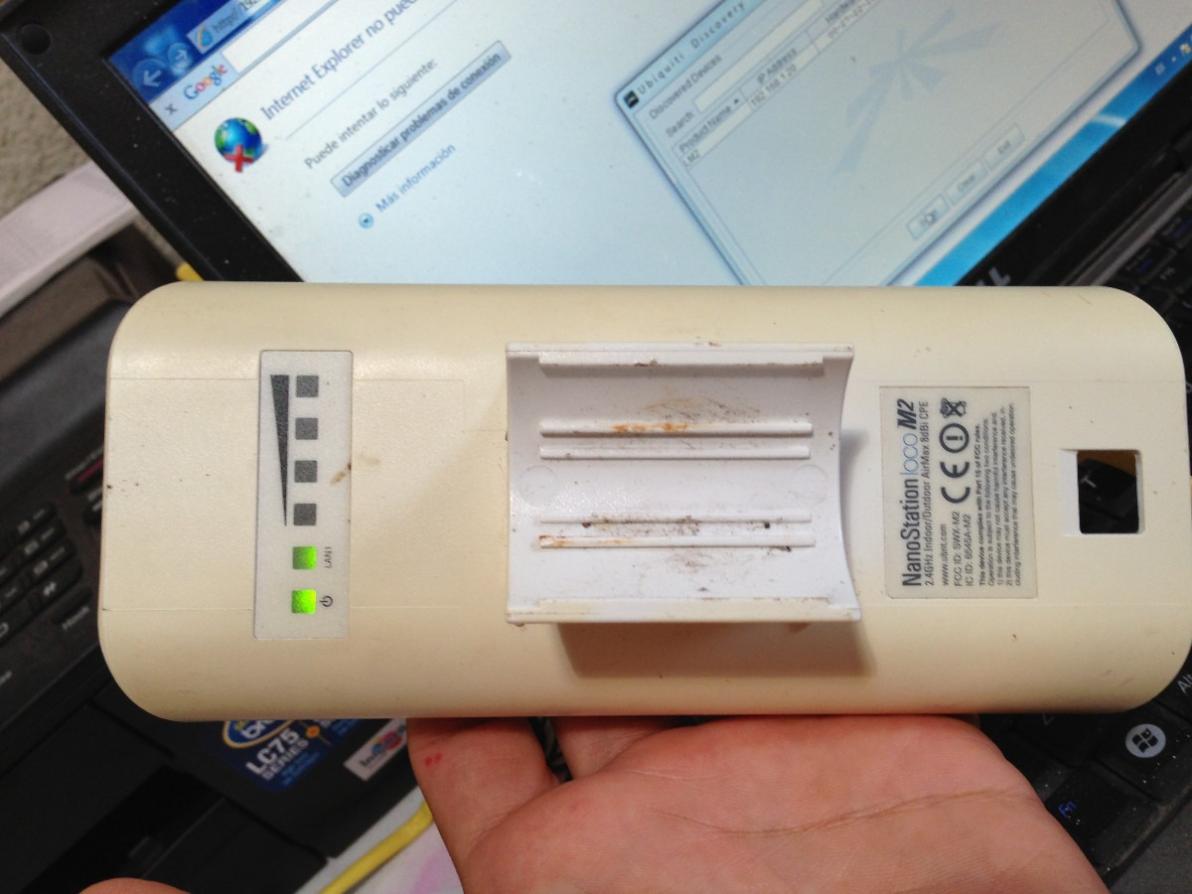

Name:	nano staion.jpg
    Ubiquiti networks is a manufacturer of high end yet low cost wireless network solutions. By low cost im talking about the ability to send video 15 kilomets thats 9.3 miles for about $150 dollars. Even better yet the Ubiquiti Nano station is a narrow beam antenna system so you align the transmit and receive units together, you arent just sending video out in a 360 degree arc, that's important for security reasons, If you don't know why maybe we can cover that later..
    The Nano station is a WIFI based system. It was designed to send wireless access to remote locations. However, with modern IP based cameras we can plug a camera into the transmitter and have its signal sent to the receiver WIRELESSLY.. Using modern IP based cameras, a NANO station pair, 24v dc power and solar to recharge said batteries it is a very easy task to accomplish. Granted cost wise the system can get pricey for multiple single camera units but that is the nice thing about IP based cameras.. Introduce a standard network switch into the design and you can plug in multiple cameras all using ONE nano station pair. Here is a extreme application.. Your budy has a retreat a couple miles from you. His house sits in a small valley but behind his house is a hill with direct line of sight to your house. He has several cameras that you would like to monitor and vice versa SIMPLE... put a nano station between the two houses and link his cameras to your system.. Heck if they are IP based you can even see them on your smart phone....WITHOUT THE INTERNET BEING OPERATIONAL...
    It may sound complicated but seriously.. If you can use wire strippers, a laptop and common sense I could walk you through it over the phone in about 2 1/2 to 3/4 hour sessions.. its not that complicated.. This is the same tech that the Mexican drug cartels are using for communications and surveillance all over Mexico...

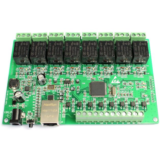

    About now Im sure some people are thinking "yeah great,, SHTF has just happened and this guy thinks wireless internet is important!!!!" I get the thought process but rather than think of WIFI as "the internet" consider it more along these lines. Wifi is a two way high speed encrypted radio signal that requires limited power to achieve long range and has a huge amount of off the shelf components designed to be used with it. Step outside of the WiFi gives me internet box for a moment and consider all the things you can do with the technology. Above I mentioned video surveillance. I think thats a pretty big force multiplier and security tool. I think it rates up there with a personal drone(yeah we will get there eventually ;-) You can do tons of other very useful things with a remote wifi bridge as well. Lets say you have a wifi bridge set up to a remote location and you have video being fed back to you. Also for the sake of the scenario you want to be able to selectively turn on and off a few lights maybe cycle a water pump or heck even fire off a propane powered flame thrower(yeah I know ,, extreme..LOL) well enter the Ethernet relay module
Name:	ethernet relay module.JPG
    connect it to the Ethernet switch from the WIFI bridge connect the wires from your electrical load and PRESTO.. remote control of your device from up to 31 miles away. Just to put this ability into perspective that those with NVG's can appreciate.. Imagine a remote camera set up on a hill over looking a valley. You have this camera wirelessly fed back to your retreat which is great but you have a concern. The camera puts out IR light at night which anybody with NVG's can see and you want to use the camera to scan the valley for idiots using nvg's but you also want to be able to use the IR led's on the camera when you want to illuminate the area in front of the camera or to intentionally display IR light for others to see. SIMPLE.... use a relay module like the one above but with only one relay instead of 8. Open the case of the camera and intercept the wire going from the power on the cameras board to the LED array. Run that wire through the relay and you now have the ability to turn on and off the IR LED's at your discretion remotely, Using very little power.
