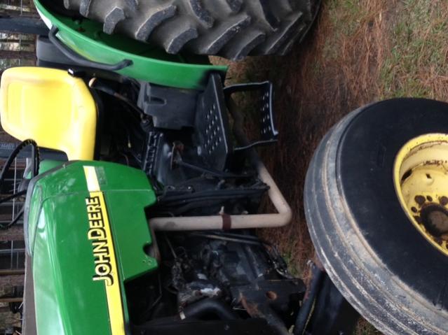

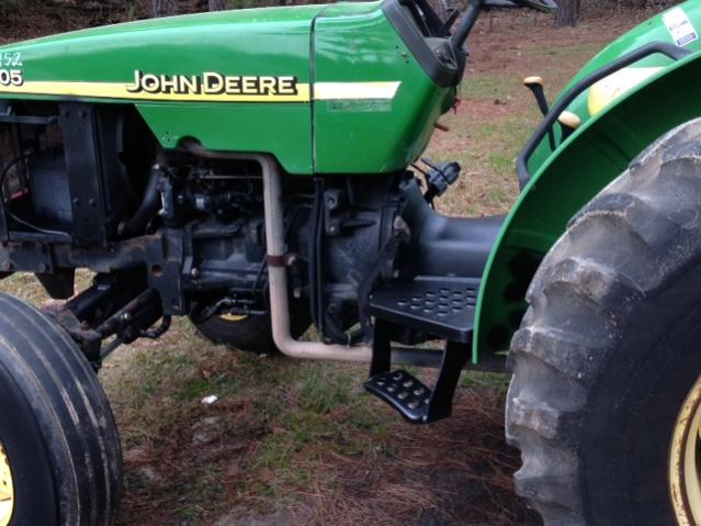

                  Ended up getting a little John Deere 5015 used. In pretty good shape overall. I've been going over it changing fluid and filters and slowly getting it up to snuff.
                  One of the things I read online says it will pull a small hay bailer, which seems excessive for this little tractor, but you know you can't always trust what you read online!
                  Any specific problems with Deere I need to be watchful for? Any systemic weak links or anything of the like?

                      There is evidently a boatload of models in that range, all the numbers get confusing.

                          yours looks to be in great shape!
                          some of the older models had a fuel screen/filter behind the seat...on the right side. a little trash and water and it would shut you down.
                          which was a good thing! but easy to clean out.
                          a few models had problems with batteries dying prematurely... I never heard of a fix... just something to keep an eye on.
                          I'm predicting great fuel economy. and think you are going to love it... and I am jealous... congrats.
