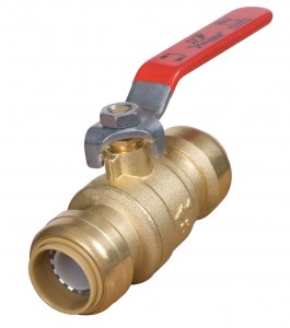

I recently had to do some pretty major work on one of my bathrooms. I needed a couple of cut-off valves to turn off the water supply for a couple of days while I replaced some copper pipe. The pipe runs through areas that make it difficult at best to sweat/solder a valve onto the pipe. I came upon these fittings at a home supply store (they're sold in most of them). They're made by the sharkbite company and work great! You simply cut and clean the pipe (00 steel wool) and pop the valve on. It's been there for about three months and no leaks!!! And, they're reuseable. They come with a 'horseshoe' type tool that you can pop them off and reuse it if you want.
