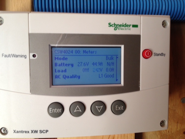

                  Replaced the wire and fuses (just to be sure on fuses- they weren't popped). And voila...
                  So I'm kicking myself for not checking better before buying the new inverter- but I ASSumed that since the voltage and hertz were reading on the old inverter, that the power was getting there, just the inverter wasn't synching correctly with generator. The old SW4024 has been a great inverter for 15 years and honestly, I may swap it back out with this one. Nothing wrong with the Conext inverter, but I'm a creature of familiarity :)
